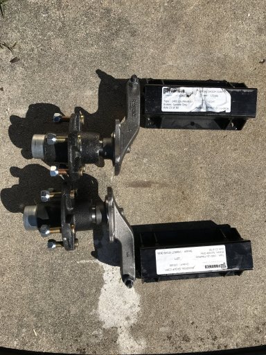

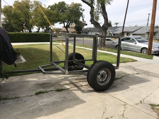

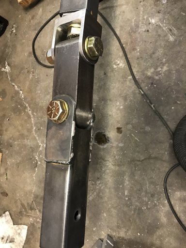

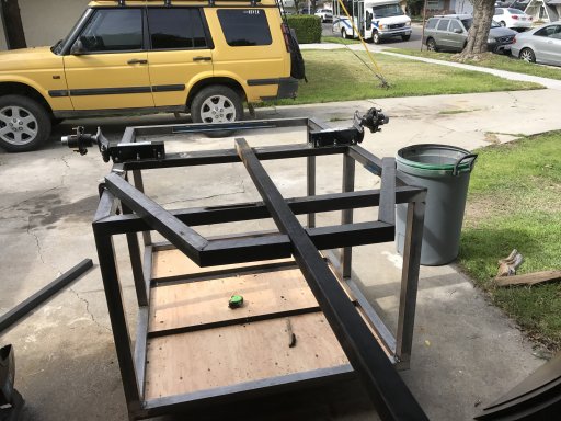

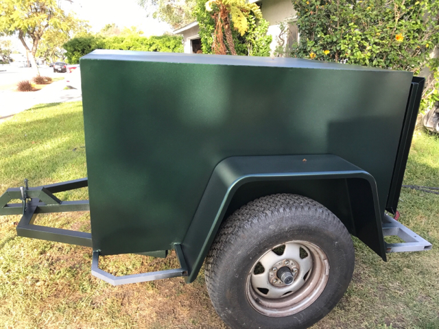

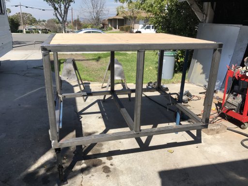

my wife and I decided to try mounting our RRT on a small off road trailer for the less aggressive trails trips. I sketched out some plans and bought the needed steel yesterday. Today I got the basic frame welded together. I will be using trorsion axles to eliminate the axle tube and improve ground clearance. I have choice between 935# springs and 1400#. I am also trying to find a good site that cover trailer geometry. From what I can find there should be 15% of the trailer's gross weight on the tongue. I need help with tongue length. Anyone have any comments?
