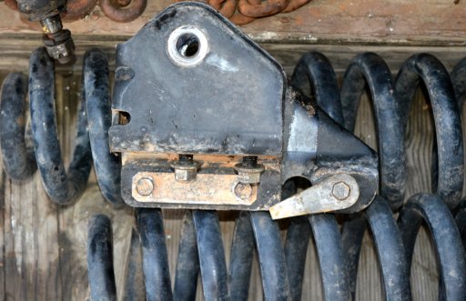

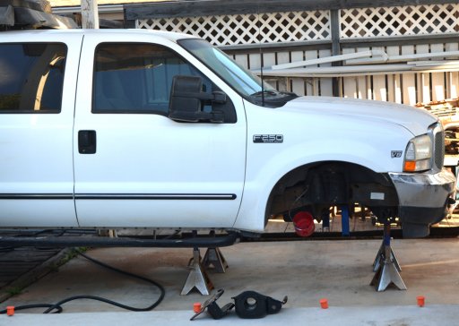

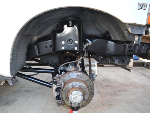

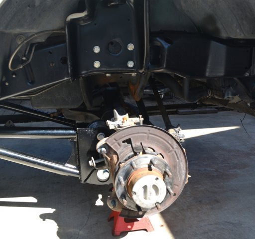

Started my 4WD conversion this week. I have had the parts for over 3 years now so it is time to put them on.
Our truck - 1999 F250 with 7.3 engine had a 6" Fabtech lift in it. The front end was completely rebuilt 5 years ago and is now for sell.
New bearings, new seals, new calipers, rotors, ball joints, poly bushings, tie rods, and other little things like the caliper hardware.

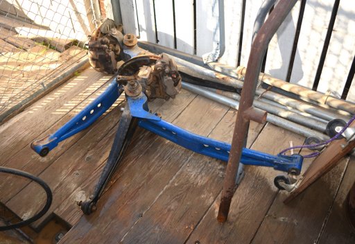

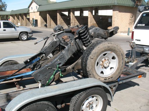

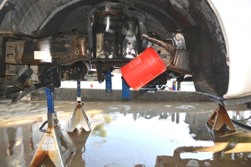

Looks a little un-nerving to see the truck with no front suspension!

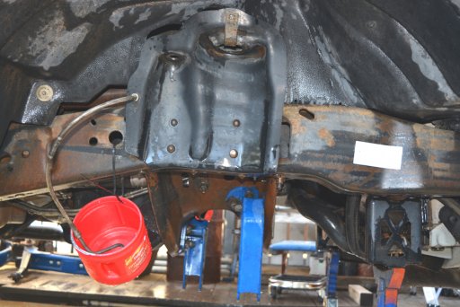

ALMOST - I have a 99 and I am putting in the front suspension and axle out of a 2008. 99 4wd were leaf spring front ends and the 2005 and up are coil front ends.
So far the only big issue I have found is the track rod mount - looks like a frame change 2006 or 07 to 2008. I may have to do addition and some welding of 1/4" thick metal to mine for one bolt.
But for the most part it is a matter of drilling out rivets and such and then bolting up the 2008 parts.

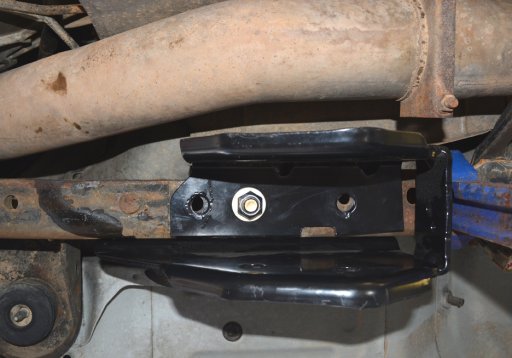

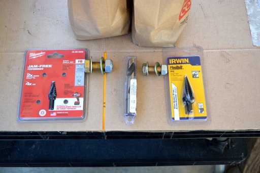

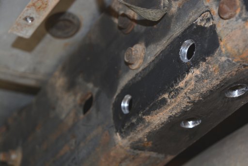

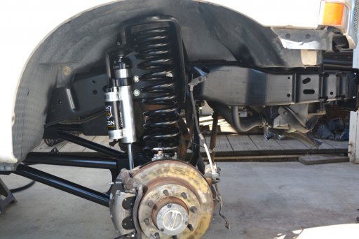

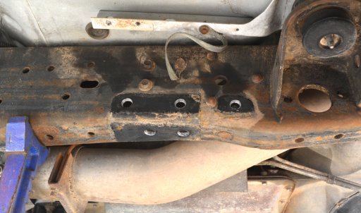

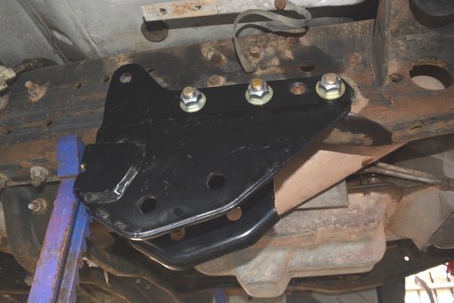

Got some more of the 2WD parts off and one of the new 2008 brackets installed - almost.
Drilling/enlargeing 7/16" holes in a frame to 5/8" is not fun, easy or safe. But with a few bruises, scarps and cuts later I got the PS radius arm bracket mostly installed.

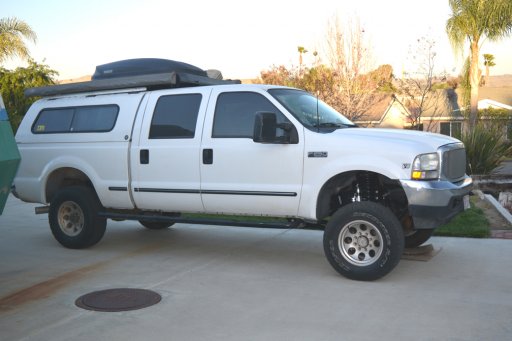

Originally bought our F250 to tow the Orange one and our R/V trailer. Then heard the word "Overlanding"

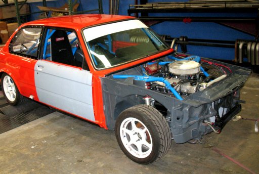

Did someone say "RACE CAR"
@Lanlubber now you OPENED the can of worms! :smileycat:
Yes, my can of worms is crawling all over me. I love race cars and trucks. My nearest race track (a new one) is 140 miles away and I dont go any more unless I can spend the night at the track in my travel trailer. The races are never over until 1:00 am and I am just too tired to drive back home. Is this your race car ? Absolutely a great little car. What kind of racing do you do with it. It's first class my friend. Love the Ranchero too. Always wanted one but never could work it into my car budget especially with 4 boys to keep wheels under.
