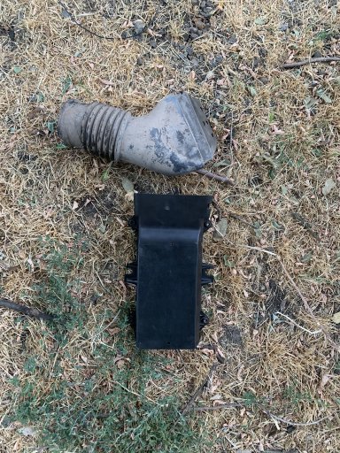

I’m looking at the Universal River Raider as well. I don’t expect any MPG, Horsepower, or any other gains over the stock filter setup. For me what it will do is move my horribly located stock prefilter intake that sucks up dust, water, and other contamination and prematurely ruins the air filter and move to a place that will get “cleaner” air. Then combined with the River Raider Prefilter I should see almost 0 contamination from dust, mud, water and bugs like I have been getting.
The dirty piece is my stock prefilter intake... the clean part is the top of my air box. The top and inside of the air box looked just like the pre filtered intake.B4DFB64A-2A2C-470A-97A1-CEAE4351977B.jpeg

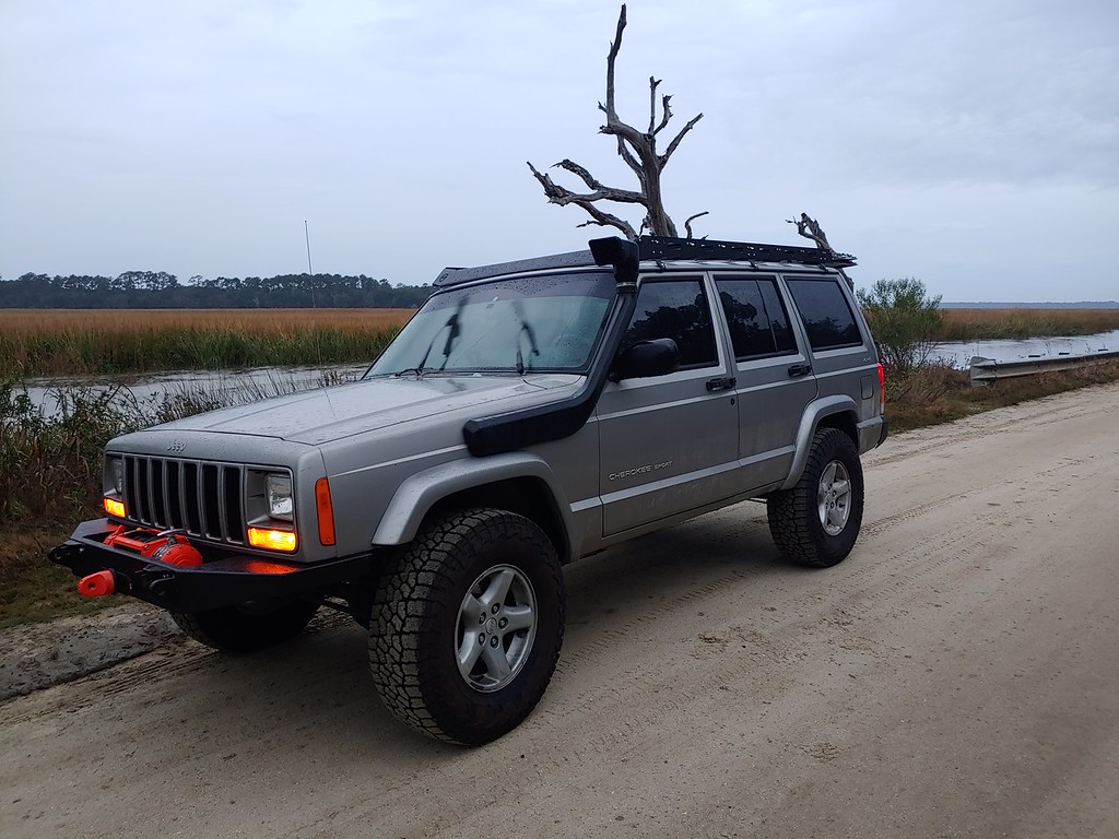

I run one because I don't run a lot of lift or huge tires. The OEM intake on my XJ is only about 28" off the ground. We have mud holes around here that are deeper than that. I bought the cheapest thing that would get the job done. Amazon, under $100.

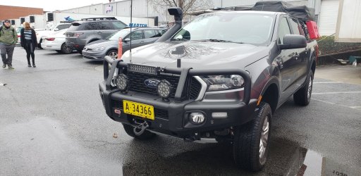

A good friend of mine, a very analytical engineer, helped me install the Safari snorkel on my truck. He said that just based off what he saw, I was going to be flowing more air than the stock air inlet on my 2019 Ranger. I increased the volume by twice based off the size of the stock opening compared to the Safari's opening. Not only that, he opined that the airflow was going to be straightened out in the Safari's down tube compared to the kinked stock inlet path.
You doubled the volume? But what's the length? Get your E an Uglies book for gas line. Even at double the diameter, it's rough on an engine. I'd recommend checking carefully on a dyno, before towing or hauling.
I'm glad that you guys like your snorkels, but put down the rose colored glasses before newbs click the thread.
