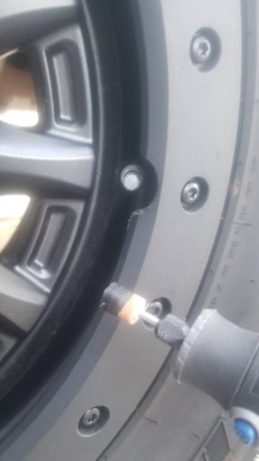

- Added 8/11 Black Rhino Duggers 17x8.5 +10 offset. Mods to accommodate wheels- shaved calipers - cut bash rings to access valves for deflate/inflate (New pix soon)

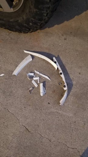

- Trimmed fenders. (2.5 inch on bottom 1 inch on top. Bent/rolled, relocated stock mounts for fender liners.)

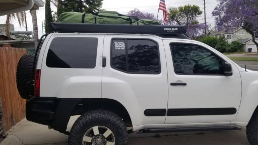

- MaxGear Aromor Roof Rack insert (user name Maxterra on here makes these has well as bumpers)
- DepHep roof rack net (works well enough with MaxGear rack)

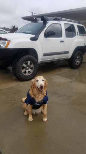

- Airflow Snorkel / Snorkel to Volant adapter sealed
- Custom relocated horn for Volant easily 100 hp

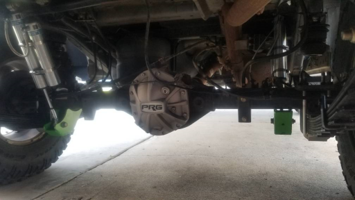

Titan M205 going in. R180 going out
T/S 2.5 Radflos, titan length brake lines, PRG hiemed tyrods, titan LCA's, and SPC titan UCA's installed
Alcan leaf packs, Bilstein 5165's, shock skids, PRG u-bolt flip kit, PRG diff cover installed
Titan suspension swap complete on stock 32's
Big Bear fun found me an excuse to get a snorkel
Snorkel Install

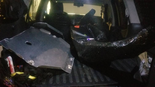

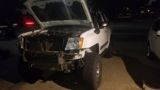

Hefty Fabworks aluminum front bumper and skid plates arrived
Bumper install
Max Gear roof rack with Raingler net. Gazelle T4 and Plano sportsman box strapped in

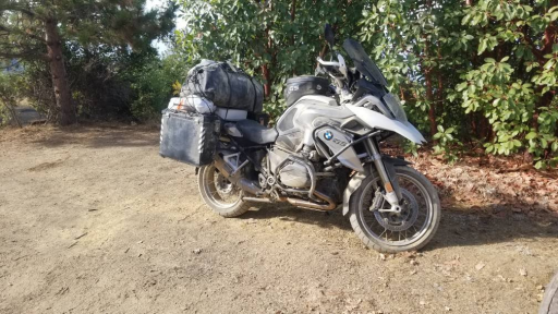

    The ride: 2015 BMW R1200GS Bought new. Now has sh#t ton of miles. 16k in the first 3 months of ownership. This is my daily driver.
    Mods:
    Armor:
    -MotoArt valve cover guards,
    -SWMotech upper/lower crashbars
    -AltRider driveshaft skid
    -BarkBuster hand guards
    -BMW headlight protector
    -BMW engine skid plate
    Luggage:
    -Bumot Panniers/rack/rack mounted toolbox.
    -BMW duffel.
    -BMW GS tank bag
    -Givi 80L drybag.
    Misc:
    -Rox handlebar risers
    -BMW GPS
    -AltRider RotoPax rear seat delete mounts
    -BMW tented screen
    -PivotPegs w covers
    -AltRider rear brake extender
    -Stickers!
    -desert pin striping, custom rock bent mounts and crash bars with patina, custom wave shaped panniers.

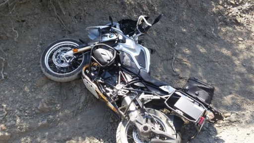

Pic of an oppsie near Durango Colorado

Oppsie near Big Sur, CA

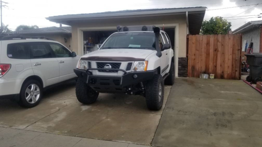

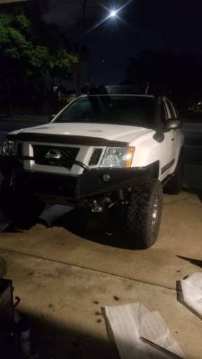

Updates

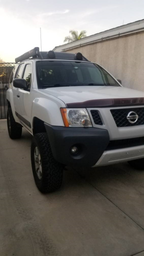

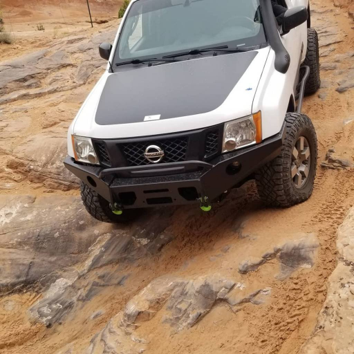

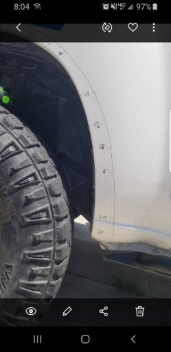

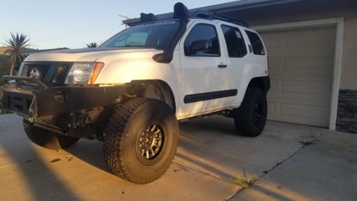

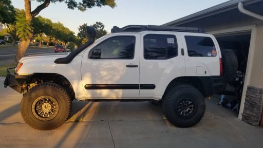

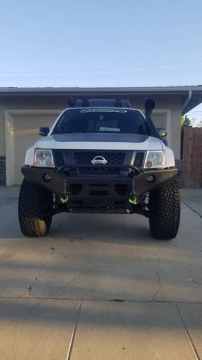

Installed new wheels and tires (GY UltraTerrain 35x12.50r17)
New 4.11 gears
Installed 1" BL
Trimmed the fenders (still need to trim wheel liners)
Dremeled half moon shape into wheel bash rings to properly inflate/deflate tires.

Nice. I think 35's are the new 33's in the Nissan world..... Currently considering 35's myself... :grinning:
