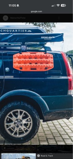

Wonder if anyone has any ideas in how the rails are mounted on this xc70. Only way I can see is they are bonded to the window somehow.
This is the rig of our member and Local Expert @XC70_OVERLANDER
I am sure, Thore is happy to tell you more about these mods.

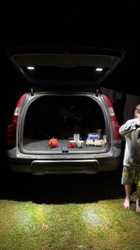

I've started with some mods.. I've mounted led lights in the boot and wired them to the rear wash wipe ( just to test how they will go) then they will be fully wired into some aux suitched on the roof lights at the front.
Reactions: XC70_OVERLANDER
