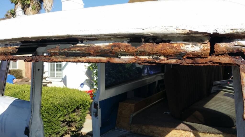

Bed liner is not a bad idea but before applying it there needs to be a good base. Bed liner directly on bare metal will not inhibit rust... it will bubble right through.
I'd also recommend a wire wheel that you can insert into your drill. I used wire wheels much more than sand paper on the rusty areas on my rig... and there was a lot!
this is just an example of how bad it can get. My truck is 47 years old so it does time but prevention is the best cure so get it fixed as soon as you can.

ha thanks for the advice guys. Burbin that's quite substantial! :flushed:
