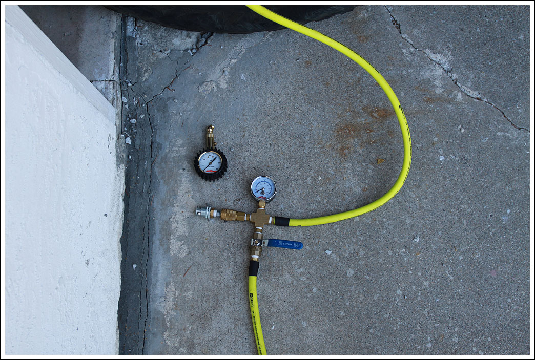

The hose setup I used to inflate the tires. The valve shuts off airflow from the compressor and allows you to get a stable reading. I've tried multiple different types of tire chucks and could write another article on that. tl;dr None of them seal perfectly well.

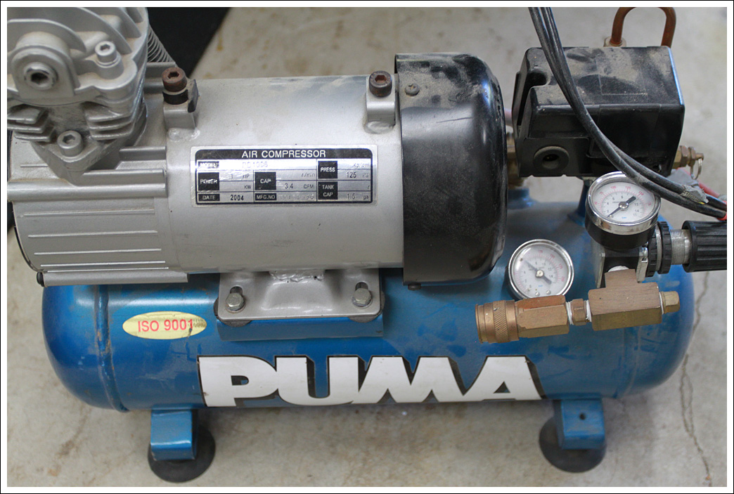

The Puma showing lots of dust, a 2004 build date, and a broken handle.

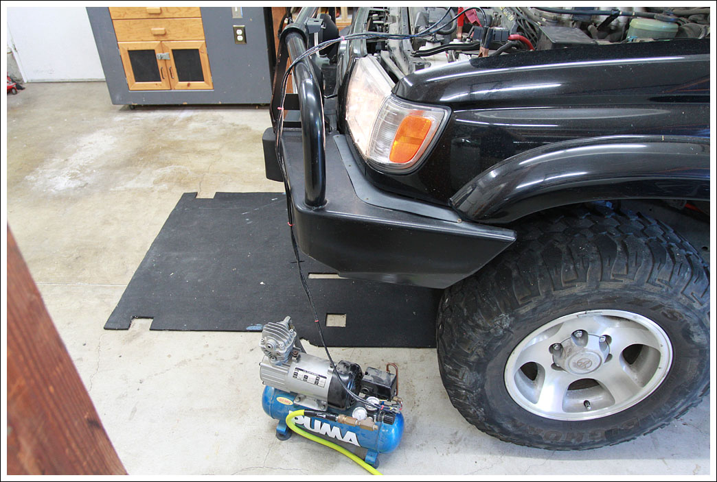

Running the Puma off of the 4Runner.

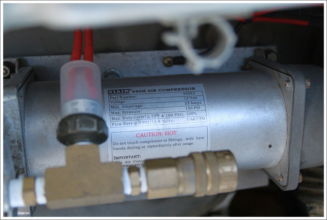

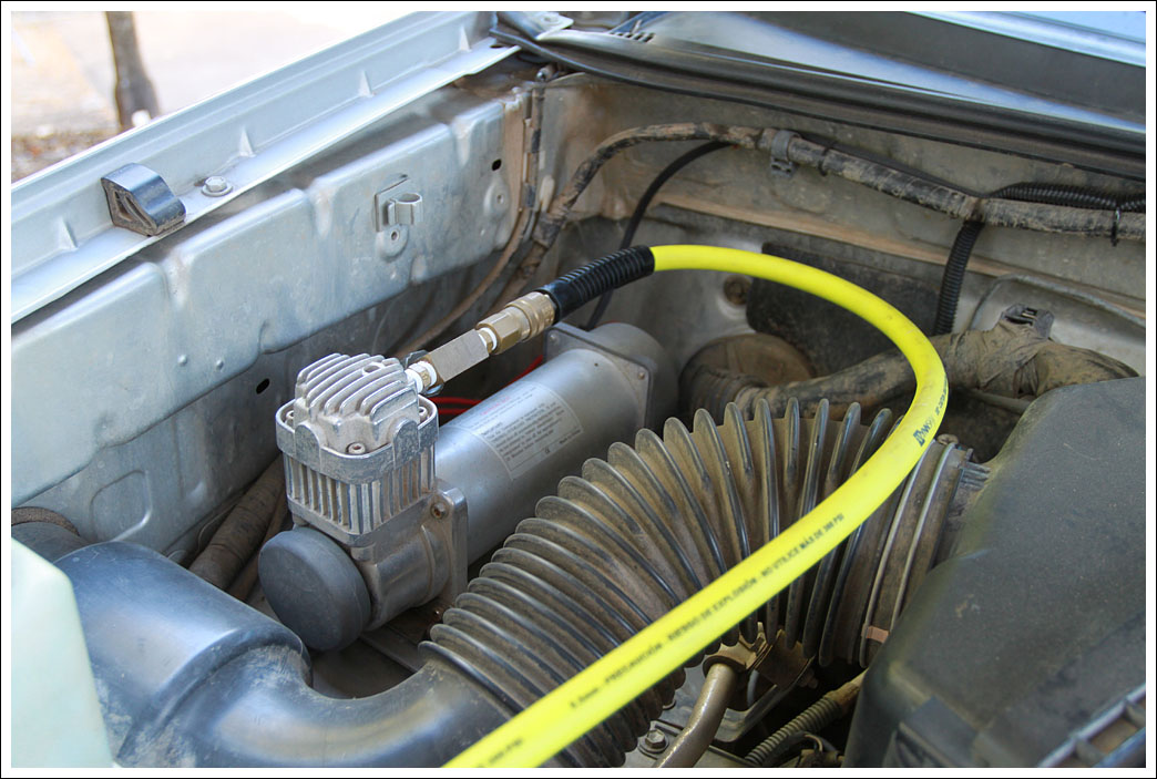

The Viair in the Tacoma. It's hooked up to a pressure switch since from the factory it used an open chuck.

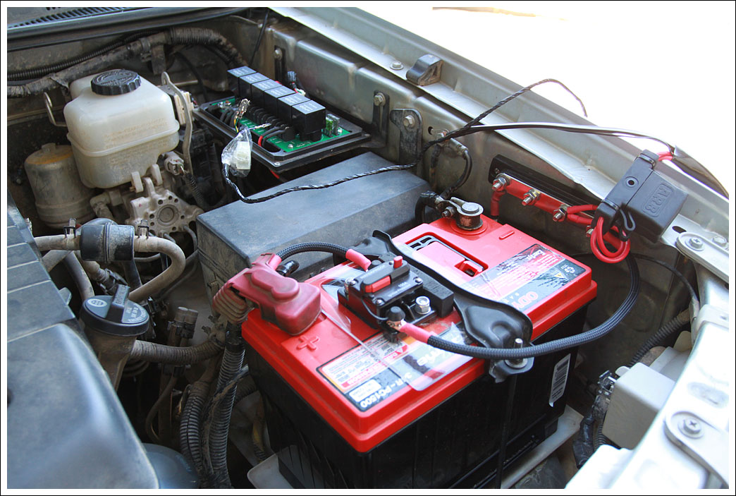

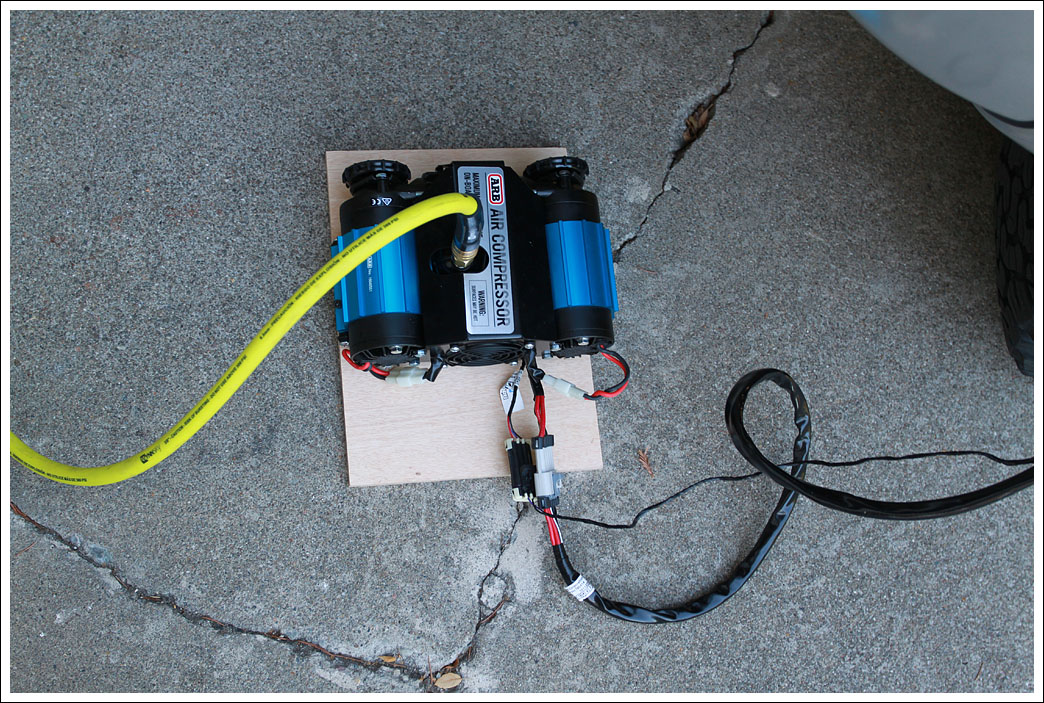

ARB dual compressor and temporary wiring.

My dual ARB setup is similar to yours. I have mine in a milk crate with my Morrflate 4 in 1 inflate/deflate system sitting on top of the compressor until I'm ready to use it. Mine is not hardwired either. I put two large alligator clips on the short harness so I can use it for different rigs. It will inflate all 4 of my 32" tires at the same time from 18psi to 40psi in less than 4 minutes.
