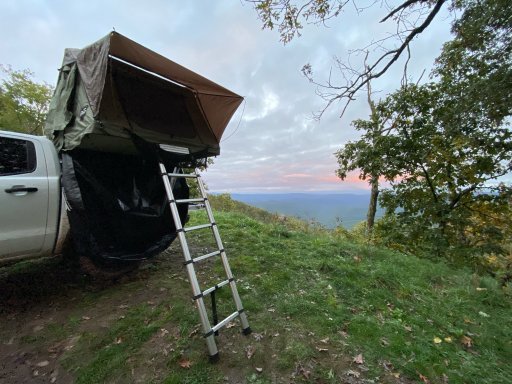

Camping out in George Washington NF my brother and I had amazing views of the surrounding area. In the middle of the night the fog and heavy winds rolled in. My RTT sounded like it was being beat from all sides. Guesstimate winds had to be rolling through in the 20’s with peaks easily surpassing 30mph. Even with the tent mounted to the rack on my Ranger, I woke up thinking I was going to be blown off the mountain.
On your second question, I know when booking through a KOA for example, they have an option for “Pickup Camper”. If tent or RV are the only options then I would go with tent. I’d only make sure that if you state tent, that you’re not sent to one of those tent sites that you need to hike your stuff from your car.
