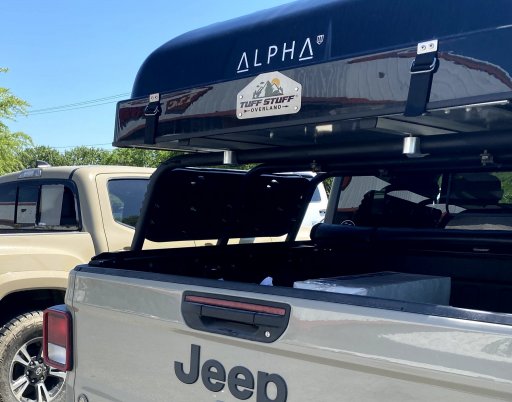

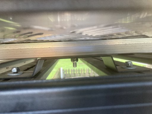

I just ordered an awning for over our kitchen and have moved the 162lb RTT up on the Frontrunner brackets so that the awning can be mounted on the rear of the racks. I’m a bit concerned about 4 grade 8 bolts being enough to hold the RTT in its place. My anal retentive self says to get two more brackets. My common sense self says that the manufacturer knows what is needed and 4 mounting points is enough. What do fellow RTT folks think?40FCA0C3-790E-4D16-871F-F5001A6E3981.jpeg

Personally, I think the shear/tensile strength of the bolts will be higher than the aluminum channel. I ran eight bolts on mine because I like drastic over kill.

That's a very strong point that I hadn't considered. Hmmm. maybe I will, after all, get 4 more mounting brackets.

Don if you would like to get a bit more solid support of the tent by spreading the load over a bigger surface, we often add 3 extra Front Runner crossbars stacked on top of the existing bars. We then mount the tent to the 3 bars and the tent can clear the outer rail perfectly. There is a bit of cutting and drilling but it is far superior in support vs the tent brackets.

I think the U-bolts that clamp on the bar are a better option.

I use FrontRunners RTT quick release clamps. Makes pulling the tent off the top a lot easier than unscrewing clamp bolts.

My bed rack has three hoops so it made sense to add two more mounting points. To keep people honest I bought some security brackets that prevent cutting through the bolt itself combined with a nut where you need a special adapter to loosen it.
