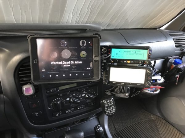

-128GB iPad Mini LTE [Entertainment Headunit | on and off road navigation and hotspot
-Clarion EQS746 Equalizer (preamp for iPad)
-iSimple JamLink Interface for iPad to RCA connection. Provides iPad charging and audio
-JL Audio MBT-RX Bluetooth Audio A2DP Receiver (connected to Clarion EQ Input 2)

-Icom ID-5100 mobile 2m/70cm/DSTAR,
Comet SBB-1 OR Diamond NR770HNMO Antenna, Diamond K412C NMO mount
-Yaesu FTM350 mobile 2m/70cm,
Samsung Galaxy Tab3 tablet running APRSDroid with MobilinkD TNC interfaced to FTM350
-Yaesu FT-60 Hand Held 2m/70cm (Hardwire charging in armrest)
