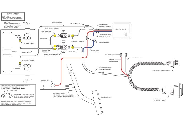

If the 4-way plug uses a t-connector or splices into the taillight circuit, you'll be in a similar situation to me when wiring the 97 Tacoma. This is what I used:
https://www.etrailer.com/Wiring/Curt/C57186.html
Here is the schematic provided with that kit that I used:
