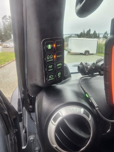

Most of the switch systems (S-Pod, Switch Pros, etc) are using a single control cable from the control panel to the relay box mounted under the hood with some type of processor working the magic to allow programmability of switch functions etc. The switch pros systems that I use are fully electronic and do not use relays so there is no opportunity to replace the control head with conventional switches.
In my opinion the benefits of the switch systems far outweigh any aesthetics of the control panel. Usually the biggest complaint is the cost factor, however if you add up the cost of individual switches, relays, way more wire etc, the cost differential is really not that bad especially when adding in reliability, safety and the number of hours saved wiring. I also did not expect to use the included bluetooth function as much as I do. being able to turn lights on and off when approaching the vehicle at night, or from inside the roof top tent is a nice feature. I like the small size of the control pad with the Switch Pro system, on the JK I have it mounted vertically in a replacement A pillar trim piece and in my Ram I mounted it to the headliner just under the sunroof opening.
View attachment 271165View attachment 271166
