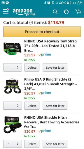

I have one of their recovery straps. Haven't had a need to use it yet so I can't speak to if it works or not. I'll say that it feels a little heftier than the Warn strap that came with my Jeep.
I don't have any of their shackles, I am buying soft shackles lately even though I still keep a couple steel ones in the recovery bag. Multiple options are always more gooder.

I bought a number of those Rhino products a couple years ago. So far I have only really gotten use out of the ratchet straps, but they are well built items as I can tell.

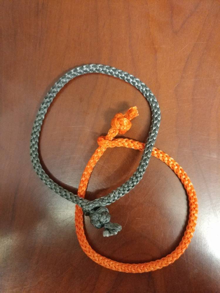

I'll jump in here and answer if you don't mind.
Soft shackles are generally safer. If the pull line ever snaps during a tug you are less likely to have a 2lb steel shackle flying at something/somebody. People have been seriously hurt (and probably killed) by flying shackles.
However soft shackles require a bit more care and attention and will need to be replaced if they're exposed to the elements a start degrading/fraying etc.

Cherni makes a great point about the steel shackle flying towards people/vehicles; it is the reason I originally went with my synthetic setup. Now after having doing a couple recoveries, I love the flexibility of the soft shackles even more. One recovery I had to use the tow strap to pull out a vehicle high centered on a rock, and the vehicle had no mount points; it was easy to use the soft shackle around the frame and gently tug him off. A second recovery was a mini-van that got stuck in snow; for that I had to use the soft shackle to attach to his axle (not the best recovery point, but in an emergency with night coming, it was the best choice). I was able to get the mini-van back onto solid ground.
For me the soft shackles present not only safety but a lot of flexibility (and they float).
