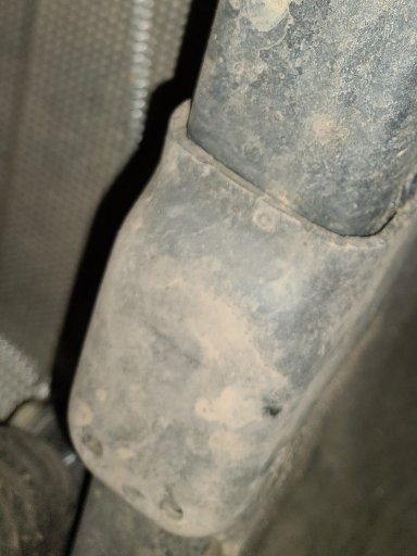

Buuuut those would add resistance, not help. Like I said, I'm not bottoming out. See. No clean, clear witness marks showing the bump stop is contacting the pad on the frame.
