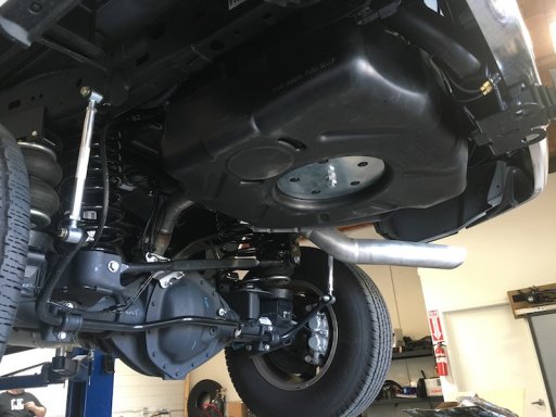

Suspension:
Installed by CJC Offroad (great guys to work with)
Carli Pintop 2.5 suspension
Carli adjustable stainless steel lower steering stabilizer
Rear air bags
Carli front passenger.JPG Carli rear passenger.JPG Airbag driver fin diff cover.JPG

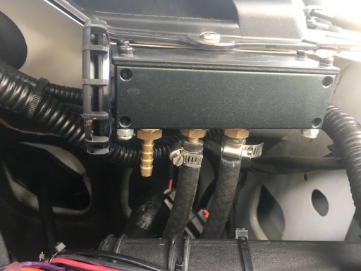

Differential and transmission breather hose extensions front (photo) and rear diff

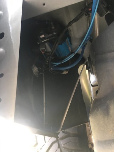

ARB CKMA12 onboard air compressor
Compressor inlet filter is located on the truck bed wall above the compressor to help keep dirt and water out.
Air hose connections front an rear

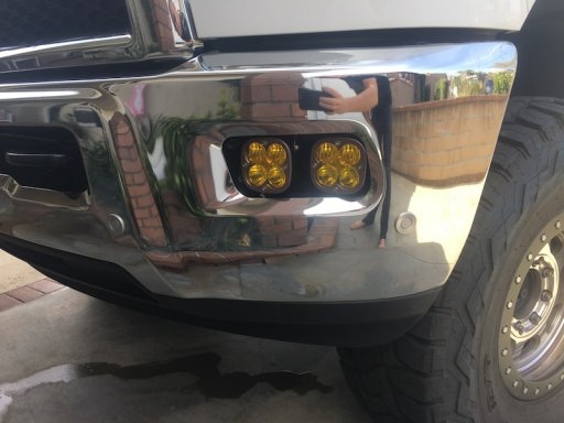

Lights:
four Baja Designs Squadron Pro, LED wide and spot used for fog lights and are very bright

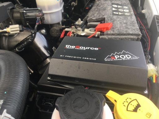

Spod 8 Circuit SE System w\Touchscreen. The Spod module controls my LEDs, compressor, lockers, and cell booster, and three more switches for future upgrades. I also have Spod controls via bluetooth on my iPhone and ipad and can be operated when truck is off
RAM mini iPad mount above stereo

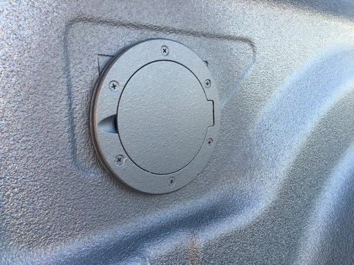

Fuel System:
TITAN 30gal Spare Tire Auxiliary Fuel System
Spare tank fuel port located inside truck bed on side wall
Propel Diesel-HPR this is awesome diesel fuel made from renewable biomass sources including recycled fats and oils, no sulfur, 40% higher setane, will not void warranty and is .10 cents cheaper than regular diesel. Much cleaner than fossil diesel. I also received a $10 gas card in the mail!
The Titan fuel controller is hard to see with the steering wheel in the way but there is actually a reflection of it in the driver side window.

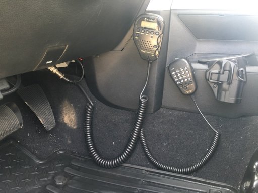

Communication:
YAESU FT-8900R ham radio with Comet CA-2X4SRB - Broadband VHF/UHF Dual Band Ham Radio Mobile Antenna
Cobra 75 WX ST Compact CB Radio with Firestik FS-4 CB Antenna
weBoost Drive 4G-X Cell Phone Signal Booster with weBoost 4G-OTR Cellular Antenna with custom fold down antenna mast
Garman Inreach

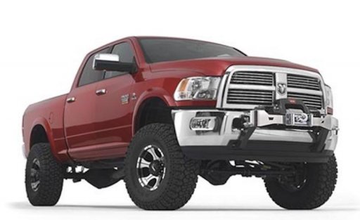

WARN Gen II Trans4mer Mounting System (all black not chrome like the photo)
WARN 16.5ti-S winch

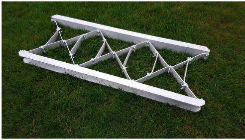

CRUX HEAVY DUTY BRIDGING LADDERS

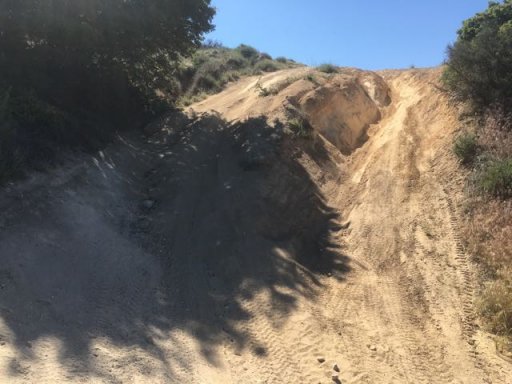

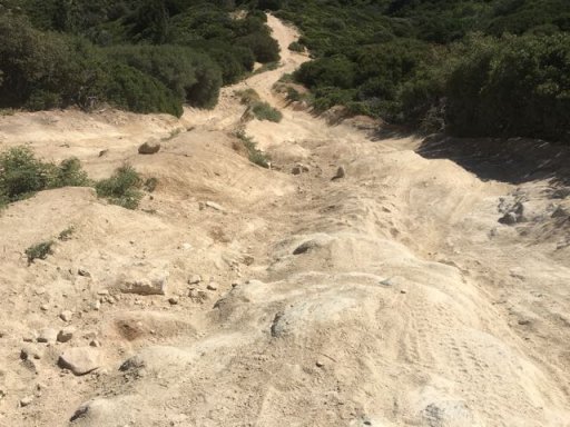

Thank you Boss324, the first time I really did any offloading was at the overland expo last year. Me and another guy drove up into the hills at night where I intentionally got stuck in mud almost above my tires. Thankfully my lockers and 4 low got me out. I also took my truck on the Cleghorn jeep trail near Silverwood Lake. That is a really fun and somewhat technical trail (for a beginner like me) especially for a full size truck imo. Not too many friends of mine are into overloading so hopefully I'll get out more now with OB.
I haven't thought about pintstriping protection. What exactly is that?

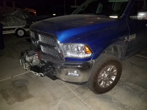

I have the warn winch mount on my truck and I've added the rack to my truck. Awesome to have a buddy that welds.
the warn rack ($550 pieced everything together off of ebay by searching the part numbers) with a Harbor freight winch because it had good reviews

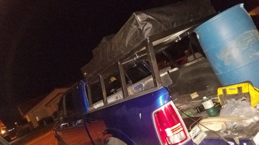

Bought the Smittybilt XL RTT got a good deal on EBay with the annex. $1265 shipped
the Smittybilt awning (the large one) I have to drill the holes to mount my brackets on the rack, will be able to pin easily to the aft section of the rack making it able to be on any side.
