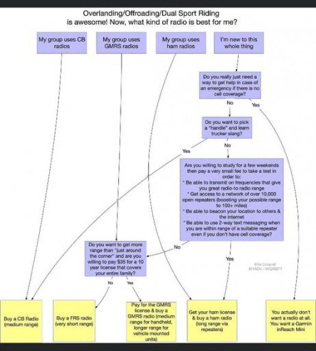

Now just need to add a column for 'do you have a radio addiction and lots of room for antennas' and then lines to all choices below …. just asking for a friend, I don't have a problem, not sure why the top of my rig looks like a porcupine

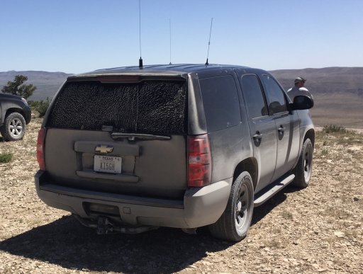

What’s this porcupine you speak of?

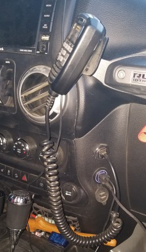

I have CB for pretty much the same reason, lots of logging trucks in our local hills and they all still use CB. did finally switch to the all controls on the mic style as it is seldom used and takes up way less space then.
OB Executive Director
I had that type also in my last jeep but sold it. I will more than likely put one in the JT if I can find room ;-)

Have the Uniden CMX760, radio is mounted under the drivers seat along with my FTM400 body. ran a cat 5 cable up under the dash and drilled a hole in a flat spot just below the level of the glove box door for a bulkhead fitting, now I can just plug in the mic and have a hanger for it on the left end of the dash grab bar. easy to unplug and stuff in a compartment when not needed. bigger issue was the antenna as I do not have good ground plane on the JK.
