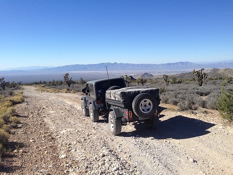

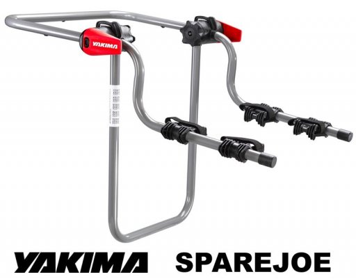

I run a spare on the rear of my trailer and have a Yakima Spare Joe bike rack. If I needed to take a bike or two with me I’ve considered running that on the trailer spare.

@vegasjeepguy, If I end up doing a receiver hitch in the rear, I would probably mount my tire near a fender to keep the weight off the back.
