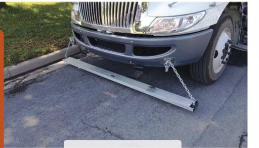

I’ve had one puncture in over,( honestly I can’t remember when,) but odds are it did happen before, 40 or more years. My father-in-law uses my barn and driveway to the barn to work on his camper and his VWs. Never cleans up after himself, a 1/4” bolt made its way through a BFG AT E. Since then I alway sweep up my drive when he is done using it. There isnt one LT tire over another that will prevent sloppy people from ruining a good day. You could get one of theseIMG_2204.jpeg
