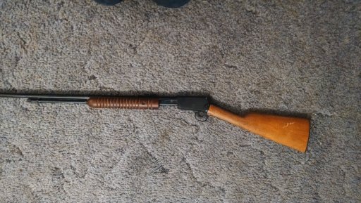

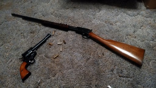

Here is a Rossi (Winchester Clone) that i referbished a few years back... as you can tell the stock was hammered... I used the technique above to achieve the results in the second picture.
View attachment 161710View attachment 161711

Nice work...looks like there's hope for my old Mossberg 500 that rubbed against the diamond deck tool box. Looks kind of like the top picture
