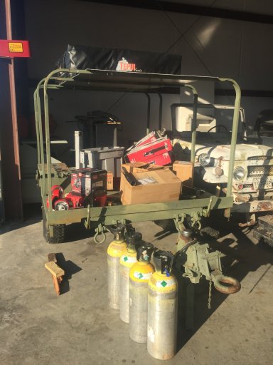

I have always had it in my mind what I would build into an Overland trailer. So after much scratching and scribbling on anything available, trying to explain my ideas to friends who just stared and nodded, I have obtained a trailer to start my build. This is actually my second trailer, the first being a M1101 that I thought too big to pull behind my '85 CJ-7. So this one is a M116A2 formerly used by the USMC to haul diesel generators. The height is right and looks right behind my Jeep. The bows are very sturdy, almost structural it seems. The items that will have to be fixed from the original "as is" purchase of the trailer are; 1) bent shock, change both shocks 2) 24 volt system, I have an adapter for the massive plug so all I need to do is change the bulbs out for LED 12 volts 3) bent and tweaked hitch with surge brake, obtain an adjustable height replacement from eTrailer.com and weld it on. So all and all the trailer is a great platform to start what I have envisioned for so many years.

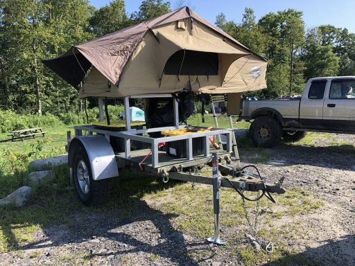

I have started striping all the connectors off the deck, there is only 14 million and they are all rusted on. I still have many to go. The deck is thick steel and does not deflect under the load of me standing on it. The bows are a little tweaked but I got them straight when I screwed on a 4' x 8' sheet of diamond plate aluminum. I also mounted my Tepui Ruggedized Kukanam RTT on top of the diamond plate if for no other reason to get it off the crate it was sitting on. It is amazing how many things will accumulate on a flat surface, even on top of a RTT stored on a crate about table high.
This is just the first weekend having the trailer and most of the work has been from the excitement of finely having the trailer. So the next couple of weeks will consist of planning, organization, and a timeline.
