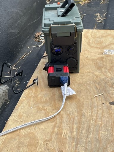

It’s pretty easy to throw something together once you’ve done the math. My current project still has room for extension cords and a bigger version of my previous battery box. New one is 2x55ah power chair batteries, 100 watt solar panel, 300 watt inverter that I stopped using because it made annoying sounds when in use. Old ammo box has a 10AH SLA. I think I’ve got around fifty bucks into each one.
Seems like a good setup. I am trying to find something similar just never made or setup anything like this. Don’t want to set something on fire ha!

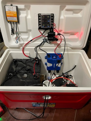

Did you choose the cooler based on size? Insulation quality? Both? Some different reason? Gives me ideas!
All of the above and more.
Cheap and light $25 crack resistant box. With how many island breeze coolers I’ve seen on the side of the road just in the last week, I’m fairly certain they are more durable than anything else you’ll find in that price range. I don’t have a dedicated rig so there’s no Gucci dividers, slides or racks, everything needs to be independent. This rides in the bed of the truck with all kinds of things that have damaged standard single layer plastic boxes and totes previously.
Size was coincidentally perfect for the two batteries with felt pads between them and left plenty of space for charge controller, fuse box, power inverter, extension cords and lights. This is all the electrical we use in one container where it is it easy to find.
Not water proof but at least rain resistant with a little duct tape around the lid opening during transport and set under the camper/truck/canopy/tarp when in use. I also throw a little rope strap around the cooler to lock the lid down against any Highway wind. The hole for wires is 1-1/4” pvc 90 turned upright on the inside and epoxied in place. Under reasonable conditions, it won’t fill with water. My previous trolling motor battery box was vented on top and would fill when rained on.
The insulation and battery mass should keep temps reasonably stable which is a bonus. I don’t think there will be much heat buildup from the inverter since it doesn’t run the cooling fan when the camper has all the lights and fans running simultaneously. My entire system pulls less than 50 watts at the battery.
