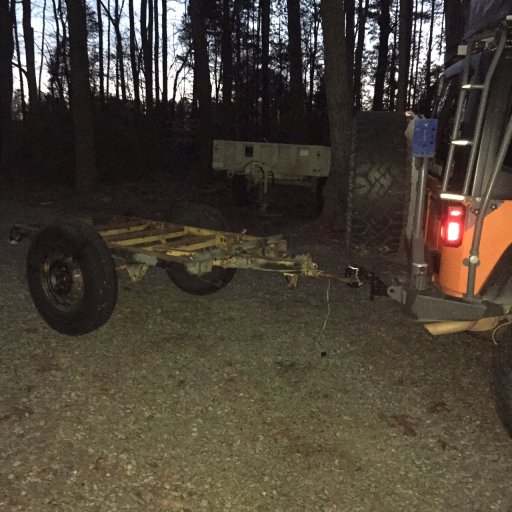

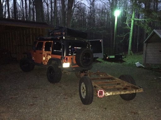

So over the last few weeks I've been stuck in a hot pump room rebuilding a IBB pump and usually that's the time I get to think about future projects like with my jeep or a possible trailer. So I came across a decent buy only a couple hours away. The M416 trailer I found was in pretty decent shape as far as the frame goes. The wheel bearings were not good at all. I think there was roughly an inch wobble to it. So I was a little hesitant on driving it back home 2 hours (interstate speeds) so I hand packed the bearings as much as I could , and I slowed down to about 55 mph. I made it safely home. Well back to the ideas for the trailer. What made me think about needing or wanting an offroad trailer was because I mountain bike and white water kayak in my free time. But with a RTT my camping and kayaking combo just wont work and my bike rack is a little too close to the ground to be going offroad with a $4K mountain bike. So offroad trailer it is! Plus it will allow me to use that trailer as a "Base Camp". So first I purchased the M1101 about a month ago, its up for sale, now the M416 frame came across the computer screen at work. BINGO! I will clean up the frame and I will be ordering a Dinoot M-series tub kit, as a first choice, and for my second choice I would get the J series Extended.

I just ordered new wheels and tires for my Jeep so I will have 5 wheels and tires for the trailer and 5 wheels and tires for the Jeep. I don't need to swap out tires on the Jeep just yet but I wanted to get a fresh set of shoes before I start out on the Transamerica Trail in June. So that has allowed me to put my BFG KM2s, with about 50% tread left, on the trailer. I'm trying to figure out where to find some good actuators or some kind of electrical arm that could be worked into the roof rack design to help with the 1-2 person set up. I was thinking about putting the two forward actuators on a switch and the two rear actuators on a switch. So all I would have to do is pull the safety pins then hit the switches to lift the roof rack up for when I set up camp.
