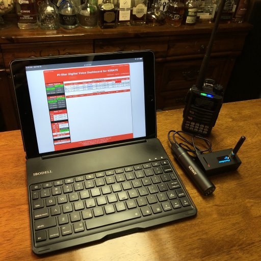

The only limiting factor is internet. I use my cell phone as a WiFi hotspot when traveling and connect my Pi-Spot to the internet via my cell phone WiFi. Once online, all the digital modes will work just like they do when you are at home. The little Pi-Spot I bought will do Fusion / DMR / DSTAR and their various derivatives like WiresX etc. I control the setup with my phone or tablet and the Pi-Spot can be powered either by the USB port in my truck or a small rechargeable battery pack I have. There is no real need to have the web interface open on the phone/tablet but I like to have it so I can see the list of who is talking and confirm QSOs Easily.
Looking over what I typed, it reads more complicated than it really is. Basically 3 things: radio, hotspot, and phone/tablet. It’s pretty neat to be able to talk to people all over the world from pretty much anywhere. Here is my mobile DMR/YSF setup Using my FT-70D:
