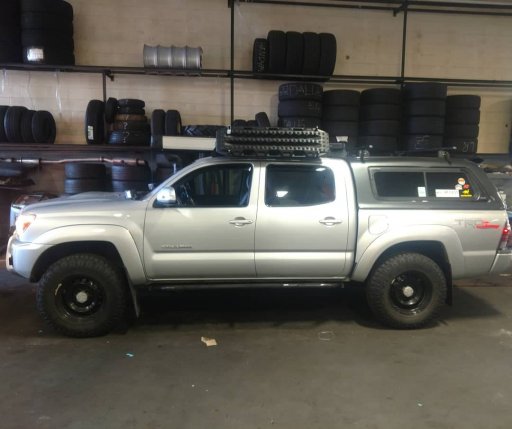

I have had the BP-51s on my 2011 Tacoma for the past three years with mixed results. The suspension works great off-road, especially at higher speeds on lengthy washboard roads and the compression and rebound adjustments actually make a difference. The bad is that they are known to leak and the lower bearings seize up. I have had both happen to me, within six months of each other. Luckily ARB stood by their product and replaced the bearings the first time and then replaced the coilovers with new ones when they started to leak. It also helps that I live 20 minutes from their North American distribution center. It is a great suspension system that has had its early issues, but like others have said they are overkill for most. I have Dobinsons basic twin tube shock and spring setup for my new build on a Lexus GX470 and they have served me well so far on the same type of tracks I took my Tacoma on.
Yes I’ve heard of the bearings seized issues nothing really big, it really is a nice setup but the more I look into it, it’s pretty much over kill for what I have plan, narrowed it down to Bilstein 6112 and 5160 with HD leaf pack
