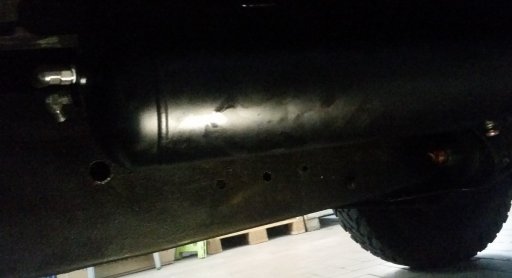

I fitted mine outside the cab in a relativley protected place on the underbody. It has about 7.5 liters/ 2 gallons of volume and about 50 x 15 x 20cm/ 20 x 6 x 8 inches in size. Choose a position where the tank does not affect the ground clearance too much. It sits on the passenger side directly next to the frame and somewhat protected behind the front frame outrigger.
My full on board air setup described here, maybe it helps you:
Extension and customization of my onboard-air system | OVERLAND BOUND COMMUNITY

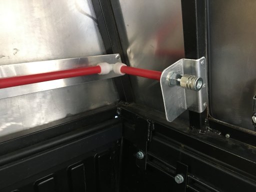

This was my Taco. 2.5 gallon tank on the back wall of the camper. Worked well and was happy with it.
Honestly did not help with speed tho. GPH moves air and most compressors are limited.
Have a cup of coffee while you're airing up and down and enjoy the day.
Zim
