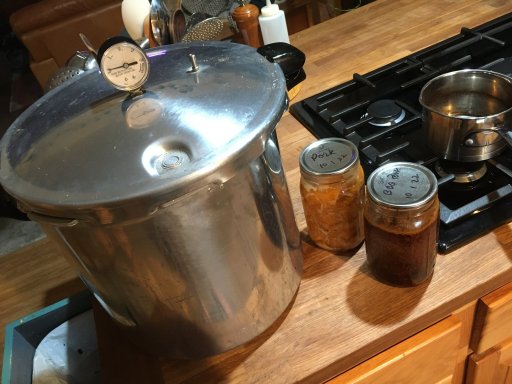

i'm 55 and i remember my mother and grandmother canning foods back in the early 70s. as a kid, i just remember that it looked complicated and appeared to be more work than it was worth...
well, that technique has been revisited as i've been looking at ways to prep and store food for longer terms than fridge/freezer. i totally get there might be an apocalypse looming right around the corner and if the world is going to burn, then i'd certainly want to have some SPAM and other comfort foods at the ready. if nothing else, living in south louisiana (hurricane alley) has taught me that disaster can strike at any time and its prudent to have some food stores that do not require refridgeration. that mindset easily transfers over into having food for camping.
i've been vacuum sealing for years and even messing some with dehydrating and storing in vacuum sealed mason jars. that works great for dried foods, but i wanted to find something for meats other than buying canned. (except SPAM...canned SPAM is perfection) anyway, canned chicken and canned tuna are pretty good, but getting expensive and sometimes hard to find. i saw a youtube video on canning recently and it interested me enough to buy a pressure cooker and give it a try.
long story made short...it was quick and easy and AWESOME results! i got a 10# pork loin and cut it into cubes and filled 5 quart sized mason jars with the meat. the wife later did a batch and added BBQ seasoning. i put 3 quarts of water in the pot and added my jars and cranked up the heat until boiling...then when the water is boiling, set the weight on the vent and adjust the heat to keep 11 pounds of steam pressure in the pot for 90 minutes. let the jars cool and they seal as they cool.
we did a batch of chicken and just added some broth to the jar and then tried it the next day. it was very good...fully cooked and the texture was perfect for making chicken salad.
so...for some folk out there, canning might be something of interest for you. i know a lot of folk go out ripping and tearing and taking glass mason jars out on trips probably wouldnt make sense to you...but for folk like us who have room and dont bounce around too much, taking jarred meats is pretty nice. i'm sure the shelf life is shortened a good bit being exposed to heat versus being stored in a cool pantry in the house, but even a month or so is plenty long for camping trips.
i just started this a week ago and im totally digging it. tons of recipes for canned baked beans, soups, etc. just wanted to throw this out there and maybe some will find it useful. there are a lot of youtube vids on this, so you can get to be a canning pro in no time

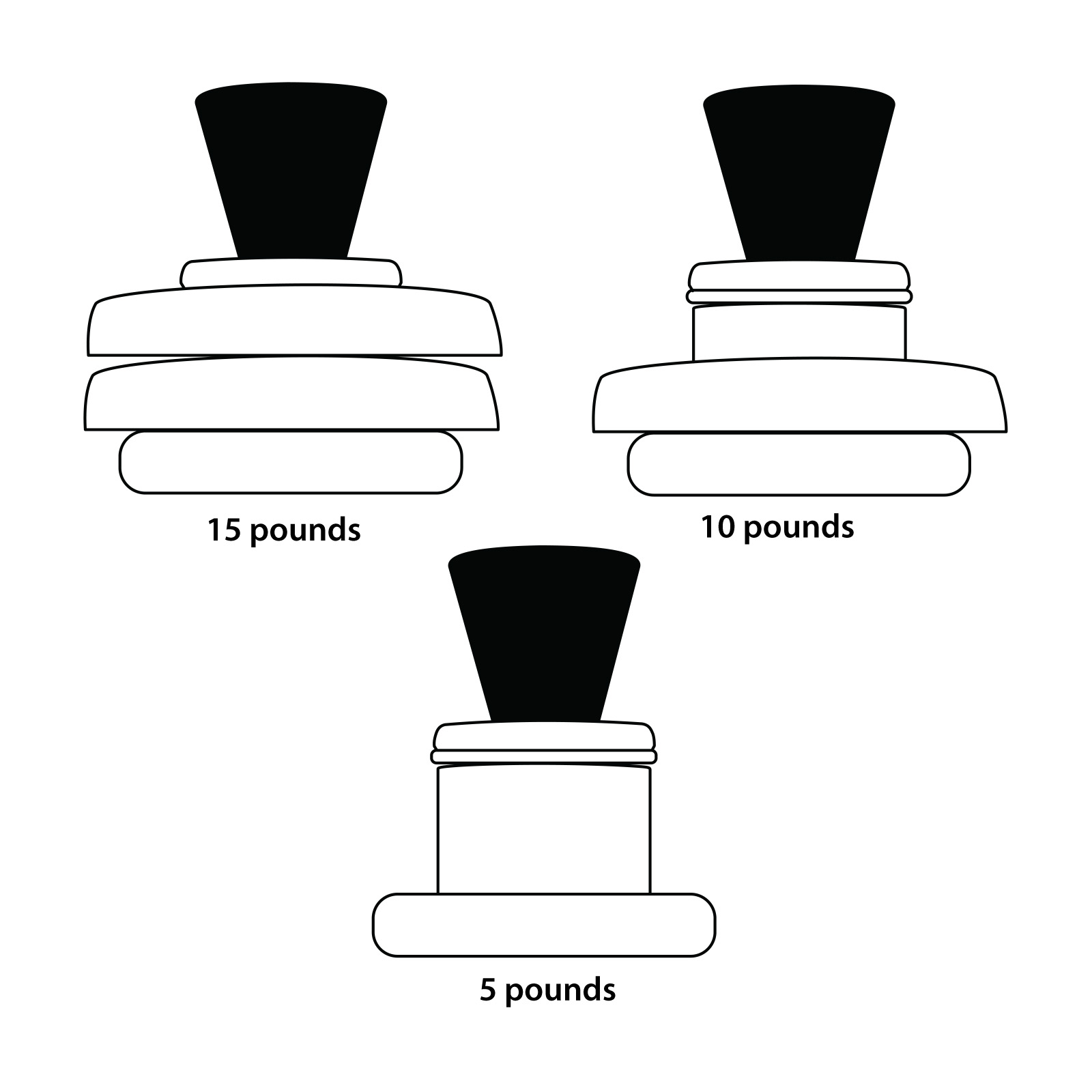

One thing I did do for my canner since they now only come with the overpressure weight for the pipe and you have to rely on the dial is to get one of these old style jigglers which you can set for different pressures-makes it soooo much easier to manage the pressure/heat. (I read somewhere that Presto sold the patent or something which is why they no longer come standard with them).
I know Amazon carries them as well.
