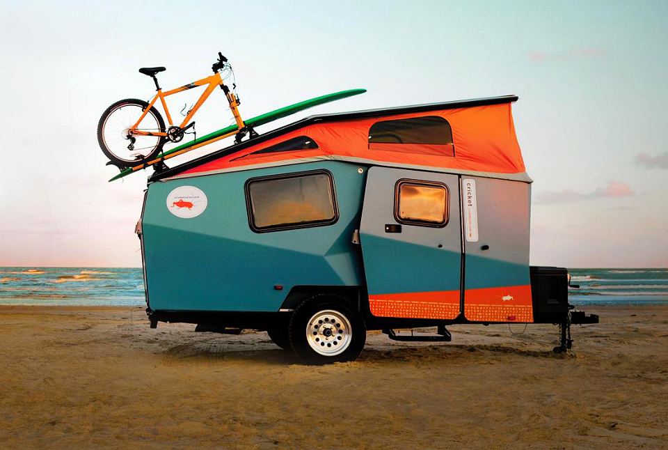

Can anyone point me towards any off road trailers that have mechanism that raises and lowers the roof tent and awning? Going to make my own trailer, but need to figure out a simple system to raise the tent to above head height.
Look up "Box Rocket Trailer" he is on several different forums and built up his trailer. He used a smaller sized square tubing in a larger one then assisted the lifting with gas struts.
Xventure trailer uses gas struts to assist in the lifting Im using the same I have bought struts that pick up 75lbs each so in theory the rack and tent could weigh 300lbs
