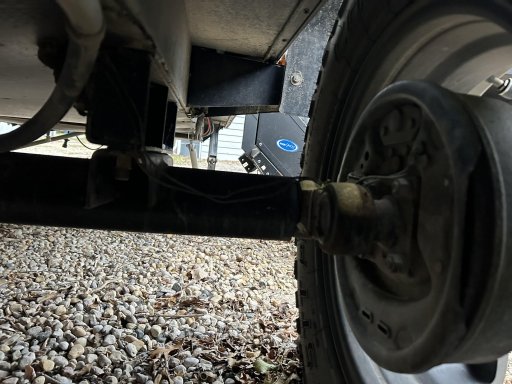

So it looks like I bent the axle on my 2018 Nobo 16.5. The camper dry is 2980lb cargo is 1400lbs.
I always travel with water @ 300lbs and with mods repairs and such I am pretty sure I am right around the rated axle weight of 4400lbs.
the axle is 89.5 hub to hub with electric brakes and 6 bolt wheels.
my frame rails are 64 outside to outside. So i have a span of about 13 inches between mounting point and hub face.
Not sure if the bend is in the tube, or in the forged spindle/ arm/ torsion beam. So not even sure I can bend it back to being right
What led me to investigate is weird scalloped wear on the Cooper STT tires. I did some rudimentary measurements with a level and it appears to be canted in at the top about 1/4 to 1/2 a inch on each side
First issue it appear the axle is custom built for this trailer
so my first plan was to replace it with the Timbren axle less suspension 5200 lb HD Axle-Less Trailer Suspension w/ 4” Lift & Long Spindles
Then realizing that my frame is too narrow and I would have to build a sub frame axle nobo.jpg
so the other idea I had was the Timbren Silent Ride https://timbren.com/en-ca/products/...ide-trailer-suspension?variant=44607187190042
this is also rebuildable units
then add a straight axle that I can pick up almost anywhere.
so am I barking up the wrong tree? am I missing a better idea?

I can't tell for sure, but it looks like a torsion axle. Do you want to move away from the current set up? If you can't fit a Timbren or trailing "A" arm you might consider good 'ol leaf springs, but with a shock. Prob an easier mod than for the Timbren.
Reactions: Mekcanix
I’d go with a Dexter axle & leaf springs with shocks. Why? Here in North America you can go into any Napa, Agricultural store, camper or trailer supply retailer and find an axle, springs, shocks, bearings.

Well a short update.
First the axle is readily available. so much for what dealership told me.
secondly it may actually be covered by a lippert warranty.
If not I am really considering long leafs and a straight axle, with a shock of some kind.
Apparently this a regular failure point on Rpods, hence the availability of the axle.
