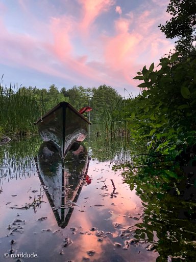

Bright Morning
Great Blue Surprise
This boat is so quiet and graceful. I gave it one last strong paddle towards this Great Blue Heron from a good ways off, then just stayed motionless as I drifted. My Nomad actually bumped the rock she was on before she alerted and took flight.
Nomad, Ready & Waiting
This angle always puts me in mind of a Viking craft, and shows the sleek design of the cheeks and end keel lines. It is a completely symmetrical craft--same going one way as the other--and though it has no real keel the length of the boat, these keel lines at each end keep it tracking and drifting in a straighter line.

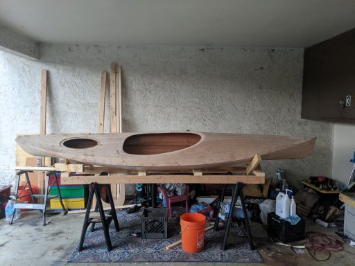

So, kind of a late follow up to this but I've been putting together a stitch and glue kayak for the past couple weeks now... I'll grab some photos when I get home, but I've finished the interior fiberglass and I'm getting ready to start on the exterior glassing of it. Its been a SUPER cool project so far.

Here's how she sits right now... we're currently sanding and getting prepped for fiberglass.
Its been a ton of work but so far it's been a really fun build.
Handsome, @rho! Very nice lines, and looks like she'll zip through the water.
Any idea on finished weight yet?
Its about 32-ish right now, I'm expecting it to end up around 35-38lbs after all the outer fiberglass, epoxy, varnish, etc. Really, as long as it ends up under 40lbs I'll be super happy. It end up a LOT lighter than almost anything else out there for the size, save for super high-end composite kayaks.
Its 12' long, and a bit wider (almost 30" beam) than an sea kayak, but this is more of a inland water type boat, with a large cockpit. It should be awesome for fishing too.
That lightness is key, in my book, and helps make it more nimble and quick. Not to mention easier to handle off the water when loading/unloading/portaging. That's why I went for what I did with my Hornbeck Nomad canoe, which is a 14' solo-tandem, 29" at it's widest, and only 28lbs empty.
I love it, and the fact that it is so easy to handle means I get out on the water that much more. Flat water boat, though, not suitable for rips and rapids.
I'm really looking forward to seeing how yours looks all finished and how she handles.
