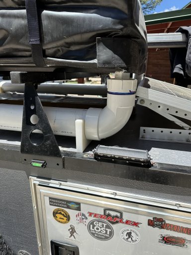

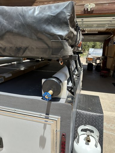

What size pipe did you use? and do you have an estimate of how much water it holds?
Larger pic of the trailer would be appreciated...I'm just about done with my first trailer build and I take a lot of inspiration from other builds.
Thanks for posting...
Good morning this is 4 inch PVC at 60” long. Have not filled them yet but between 4-5 gallons I think. The fill spouts are only three inches as I used a reducing 90. I’ll post pics of the trailer
