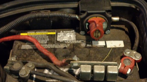

16872
The image that I think I attached kinda shows my set up. I was trying to really push it by throwing in an espresso machine. It worked well enough that the next week we met up with some friends while camping and surprised everyone with espressos and lattes on the last day. We also have a 120watt solar setup from Go Power. It keeps my deep cycle battery charged no problem. However, we don't even typically hook up the solar when we are moving around everyday because the alternator charges the batteries up pretty quickly when rolling around the trails.
