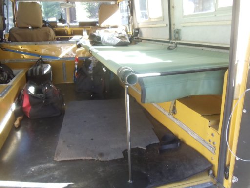

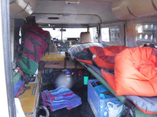

I put cots in mine. I removed the frame from the canvas and inserted a section of pipe. One side I have sitting on hooks I made to hold it up and on the inside I made a front bracket to hold that and a leg/foot and a spreader bar. These just fit into holes in the pipe.
I can roll up the inside pipe to the side pipe and secure it with a strap. This gives me room for "stuff" when traveling or just day to day use. I made 2 cots this way so if just stopping for the night we don't have to set up a tent. In the second photo you can see the left cot rolled up against the wall, it has white pipes as is the mount on the seat back bulkhead.
