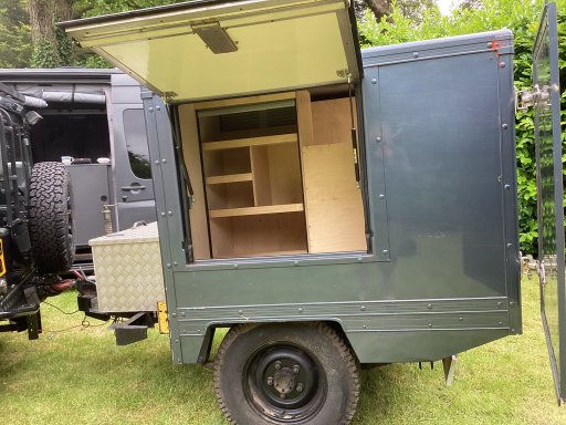

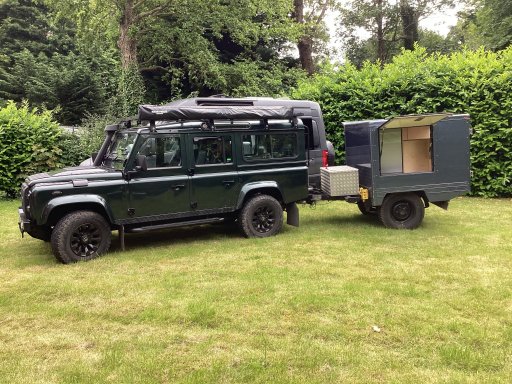

Internal fittout 90% finished Roof rack for rtt under construction wheel’s original british army rims but changing over too landrover boost in the future.
power source will be abattery pack , water tanks under construction

Is it based on a wide or narrow track Sankey? looks good, what else needs doing?

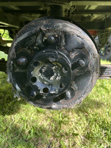

Well chaps ran in to a bit of trouble running the trailer back to base , brakes locked but only while reversing ,
straight on phone to ex military grease monkey. who gave instructions and after own loading a very informative
doc of the expedition portal i resolved the issues well freed it up. But for me with no mech experience

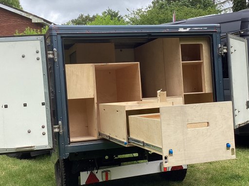

it was a very satisfying experience here a few photos of the interior. All thanks to my nephew

Update my ex. Military grease monkey just called and smiling said you aint been trying to reverse that have you ,
weres your blocker , what blocker seems there a pice should be slotted in to stop the reversing brake working. ,
another lesson learned

your trailer is on drum brakes,I think some sankeys have a disc setup don’t they? I wonder what make of brake parts they used? How do you get on with the NATO hitch?
