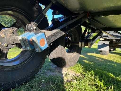

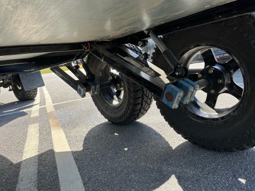

Using plastic tube clamps to hold on an axle seems irresponsible at best. I also can’t figure out what that double heim joint looking thing is for. It looks like it fixes the axle height, but then there would be no movement of the axle.
Travel limiter for hwy use. Disconnect for full articulation and travel. Neoprene split pillow blocks have been used for decades.
Nylon Split Pillow blocks have been used for decades on all types of manufacturing designs. The double hiem is probably a ride height bracket he could use for hwy use and disconnect for full articulation. The suspension system is also decades old.

Please explain how your suspension is suspended, and how it is supposed to move. I see no spring or air bag. It looks locked into position.
I just make a movie for you that Will be easier for me.
