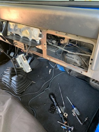

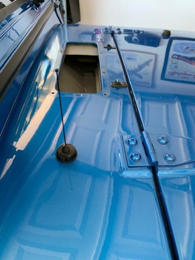

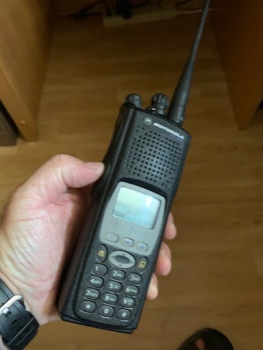

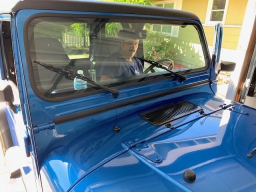

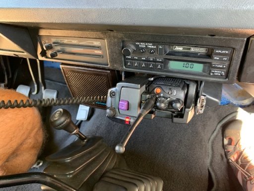

I should explain that I'm a ham radio guy that has worked with Motorola gear for many years. Most of my radio gear is Motorola so it was a no brainer when I decided to put a radio in the Jeep what it would be. This post is to show that you can do a lot with a commercial radio if that's the way you decide to go. I have both ham and GMRS licenses so I decided to use a Motorola Convert-A-Comm with an XTS5000 UHF radio. I programmed the handheld radio for all of my local ham repeaters as well as the common ham simplex channels. I then programmed in a separate bank with all of the GMRS channels. The antenna was designed to be very low profile so that it won't hit trees or be noticed by potential thieves. The radio only puts out about five watts but works all my local repeaters and talks simplex a solid 5-6 miles. This is more than adequate for what I want to do. I can also take the radio out of the Jeep in seconds so that it can't be stolen or if I want to use it on the ground. Notice that the 1/4 wave antenna has a more than adequate ground plane for UHF frequencies and stays out of the way.
Just another way to skin that GMRS cat!
