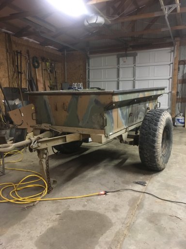

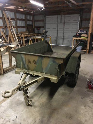

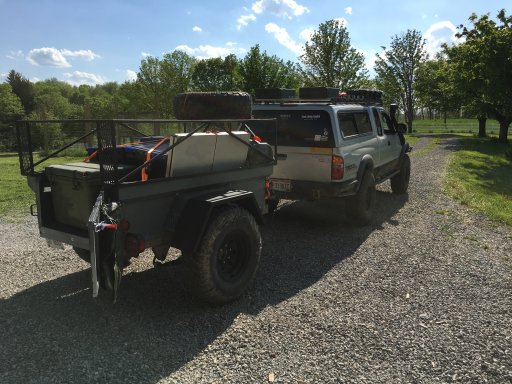

Just started following your trailer build and wanted to add a bit of my build. I picked up a Bantam trailer three years ago and wanted to create my own off road capable trailer. Trailer was mostly stock with a first gen CVT on it. Tent is no longer made. Started fab work with wheel adapter, 33 x 12.5 tires and installation of side fenders with storage. Second project was cutting off front end. Rebuilt front end for tongue box, fuel and water storage and 16” longer tongue with max coupler. A couple more projects in the works will include solar, perimeter lights and a rear bumper with spare tire carrier._storage_emulated_0_DCIM_CVT-09 M100 Tent Trailer_20181015_182538.jpg_storage_emulated_0_DCIM_CVT-09 M100 Tent Trailer_20190628_191802.jpg_storage_emulated_0_DCIM_CVT-09 M100 Tent Trailer_20191113_114327.jpg
