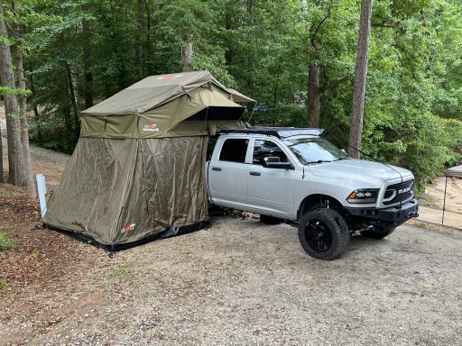

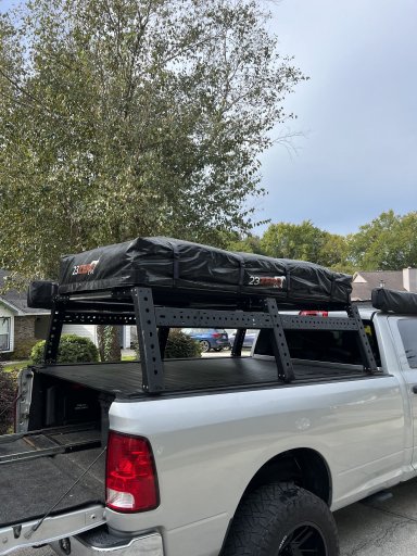

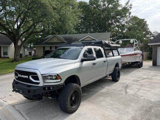

I have the voodo Fabrication max modular rack on my 2500 I have mine at cab height I think it’s an 18” by 88” since I have a long bed. I like the cab height so I can walk under my RTT and use the Annex. And with my 270 awning I wanted higher mounting to walk under. I’m 6’4 so it’s needed. A little more work to set up the windows on the tent, be we usually do it from inside.

mines a ram long bed so nothing out there would touch my cab. I have 8’3” of bed length to play with. That’s why I went with Voodoo. They make an actual long bed rack. It’s 88” long. Plus it mounts into the track on my tonneau cover. I went with the 23Zero tent because of the light suppression technology. It’s pitch black inside even in the brightest sunlight. Plus it was a king size bed, and 53” to center inside. We basecamp mostly at the lake with our boat. So being comfortable after setup was important to me. I’m 6’4 and can stand having to crouch or stoop for everything, hitting my head and so on. Love the annex for changing and dry storage too.
