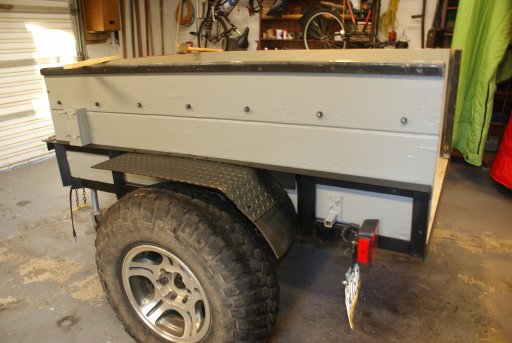

I found some 1/8" diamond plate at work in the shop. I purchased the plate and my welder cut them, formed them then I mounted them as high as necessary. All for way less than 50 bucks.. they are very handy being flat. I then added the mudflaps from scrap flaps found along the highway.. DSC01833.JPG

I found some 1/8" diamond plate at work in the shop. I purchased the plate and my welder cut them, formed them then I mounted them as high as necessary. All for way less than 50 bucks.. they are very handy being flat. I then added the mudflaps from scrap flaps found along the highway.. View attachment 30315
I like this idea, we might even have the same trailer. Thank you!
