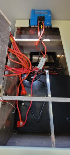

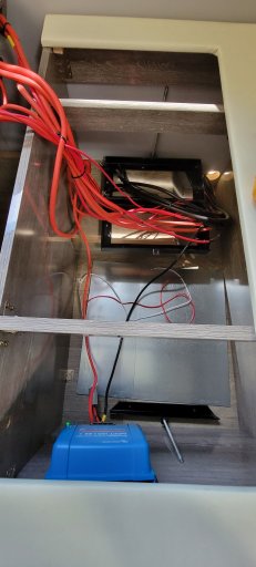

As I was taking it all out I found that Black Series already had a vent fan inside to the exterior. I think this will work for now and maybe ill take the other hole drilled and have it as another vent fan. Here are pics of the install. Went up to 600ah (2x 300ah) of useable LiFePo4 batter capacity. It also cut the total weight in about half. Those AGMs are heavy! Wire the heating pad as well as the temp sensor the the bus bar. All is working well, the mppt controller topped them off in a few minutes and went to absorption to level them out.
Outstanding!
