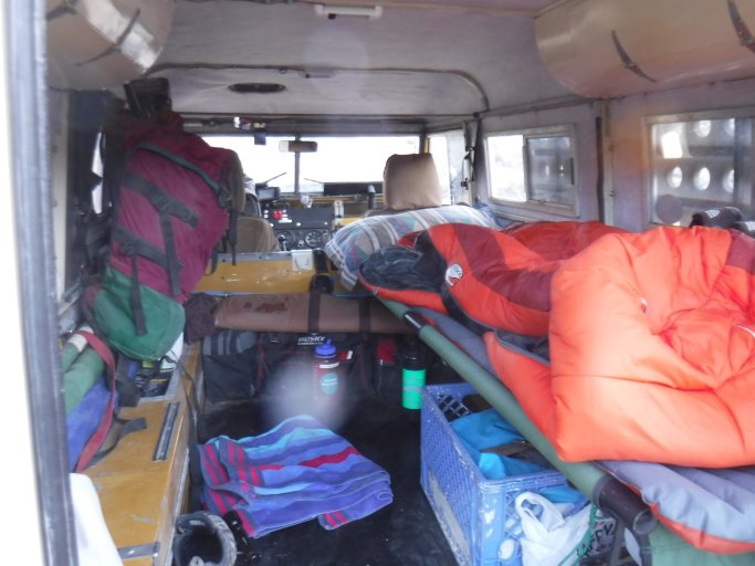

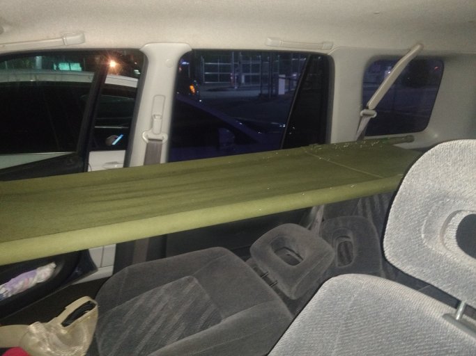

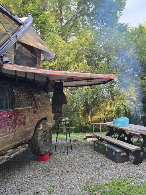

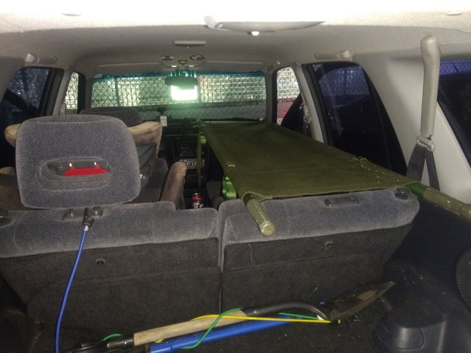

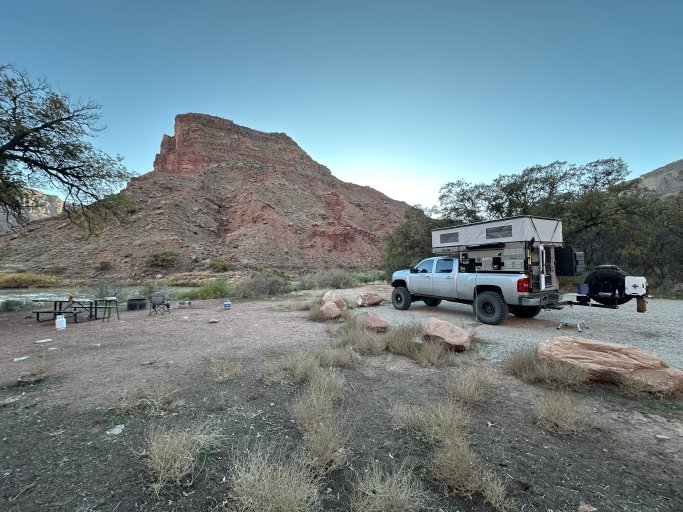

When I am solo, the LC is set up for sleeping on the 80/20 platform. A NEMO sleeping pad provides comfort. The Snow Peak table attached to the tailgate provides easy flat space to cook dinner etc.

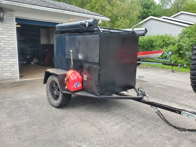

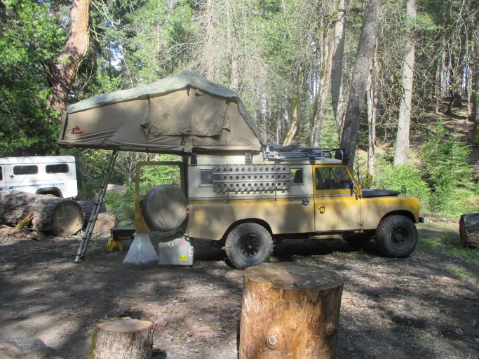

The Chaser comes out when the wife goes along. The Eezi Awn 1800 is the most comfortable tent I’ve ever slept in and the 2500x2500 awning creates a great space to congregate out of the sun.

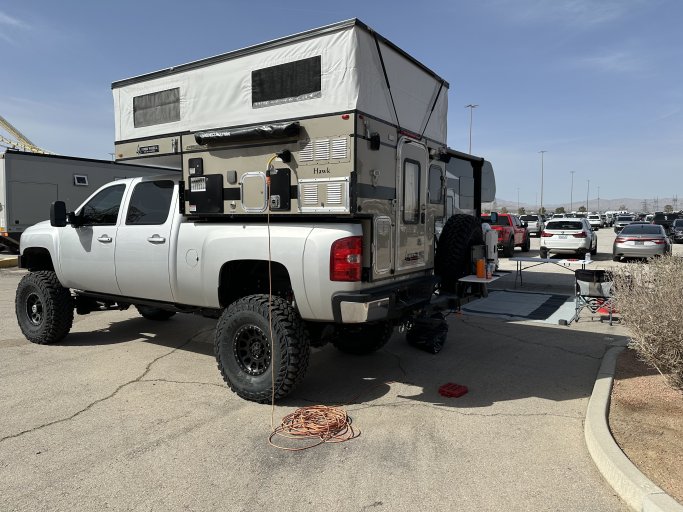

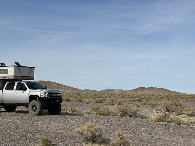

My set up

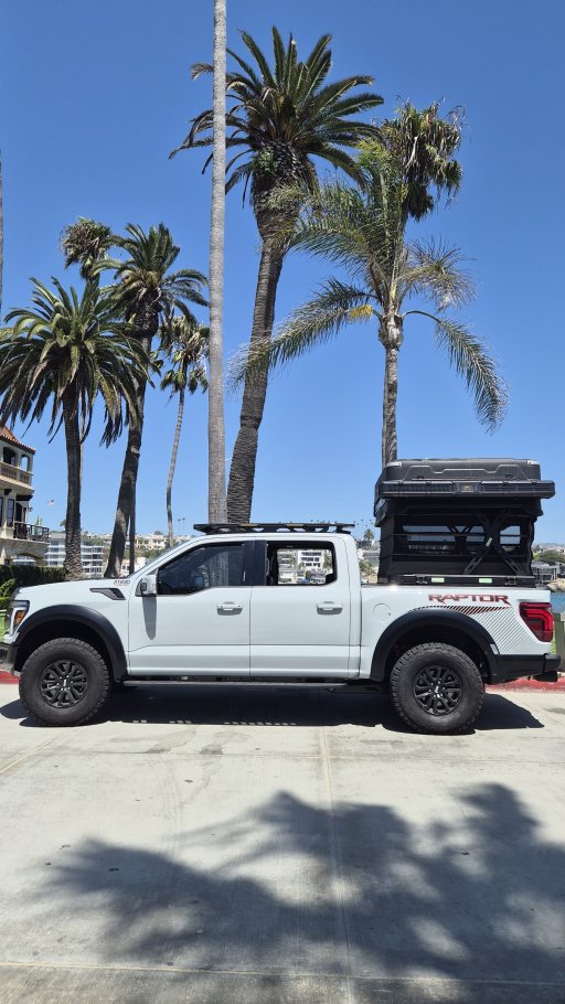

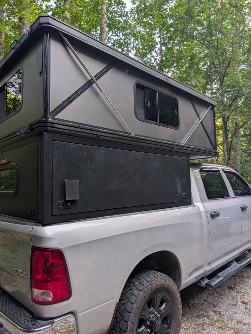

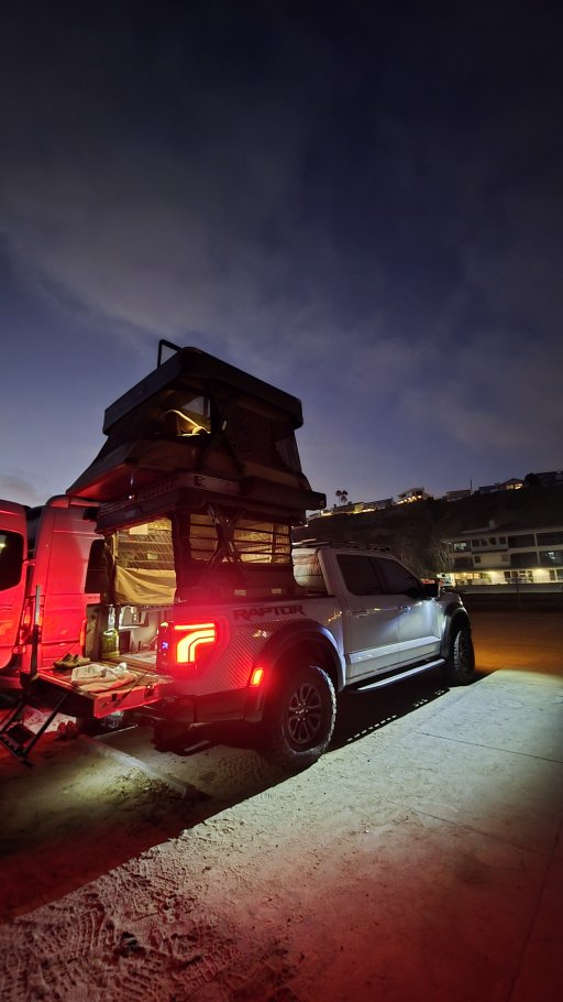

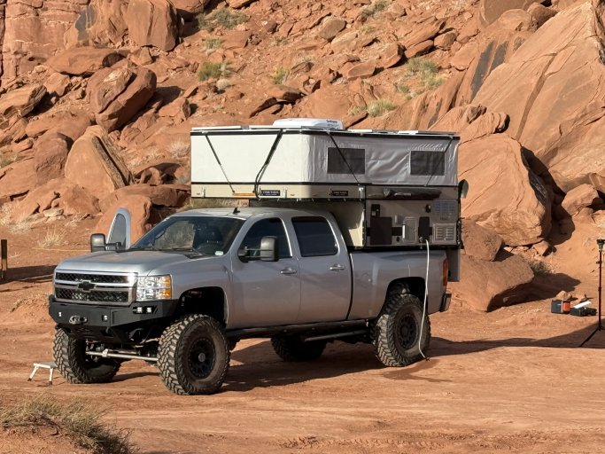

I like that side opening door on the shell!
The hatches on the Ovrlnds are great. Saves a ton of climbing in an out. I have my water plumbed to a Dometic Go faucet that sits on the inside cabinet, but can be reached via the hatch and put on a magnetized shelf attached above the wheel well for outside use as well, which you can see if you look closely. In a day of camping we must reach in through that hatch or the opposite 20+ times. Makes things more efficient by far!
I made it from a scrap piece of 1.5 x 1.5” 1/8th aluminum angle. I VHB’d a gun magnet to the back (used the white LSE VHB as the magnet was rubber enclosed) and then VHB’d the round steel Dometic “landing pad” that comes with the faucet on the other side. The landing pad is half off the aluminum angle, but the VHB is more than strong enough to make it secure. I also applied some 3M paint protective film in a few places where I use it outside. Easy project!
The one thing I’d do differently now, would be to make the piece of angle a bit longer so there’s room on the horizontal surface for a camp soap container, but I just keep that in the hatch or sit it on the sill when using the faucet outside.
