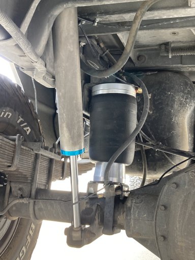

I just installed a set of Deaver expedition leafs a couple of weeks ago along with Peak 2.0 rear shocks, night and day difference. With the way I have my truck loaded the new rear suspension makes it feel like I'm not carrying anything. My truck is never not carrying a load, thus the expedition version of their springs. I'm sure other companies are good as well.
