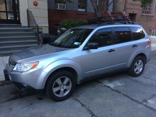

The first modification I had to do that I felt was not common was to my roof rack. I found a steel roof rack that I very much like the look of, however its cheap and the design affords water ingress which will eventually destroy the steel leaving the rack left in a trash pile. Of primary concern was that the tubing was physically capable of flooding internally without ever knowing if there was water inside.
Water ingress points clearly visible, tubes would flood during a rain IMO:
Top side bar also with water ingress points:
After considering some silly fixes, I opted to use F4 tape. If you've never heard of this stuff, apparently it's awesome and I suggest you check it out. I'm about to find out if this application is a good use for it, but essentially it's a silicone tape that bonds to itself once you stretch it tightly and wind it over itself. It becomes water tight, has an incredibly high temperature rating and very high PSI resistance and also insulates up to 8K volts. Not bad. So I decided to waterproof each of these ingress points with F4 tape and the results of two (2) full wraps over each point of ingress are as follows:
Tape used:
Two full wraps on ingress points:
And:
I also did not like that the snap on side covers to this roof rack were not secured, so I drilled holes in them for cable ties to secure them permanently:
Affixed to rack:
The side covers help disguise the F4 wrap, and so does the wind deflector which I removed the label off of to match my car's gray/black & silver look:
In the end it's hard to tell I've wrapped the rack at all, and if the tape is as good as they say I feel I have a shot at keeping this rack a few years. I hope very much that is the case.
The rest of my mods so far are too standard for photos but I'll keep you posted as the vehicle evolves. Thanks for reading.
Nice, that's exactly what I did to my Rhino Xtray as well. Mine came with some very annoying rubber sleeves that were supposed to "slide" over those joints. I ended up tearing two of them trying to get them on and then just threw the others in the garbage. I've used the silicone tape on a few other things and it's awesome stuff. It's also survived several crazy freeze/thaw cycles with no problems.
I never thought about ziptieing the plastic X brackets in place; that's a good idea. Currently, I'm working on some brackets to hold the MaxTrax onto the rack.

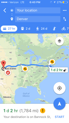

Moved out of NYC. Long ass road trip. Some photos below:
Updates since last post:
  1. Painted my factory Subaru recovery eye hook black.
  2. Purchased and install 2" trailer hitch.
  3. Purchased recovery boards and mounted them underneath the...
  4. Installed Tepui Kukenam Sky RTT
  5. Installed Thule 50" crossbar set (came with my RTT)
  6. Installed CB radio
  7. Bought Wally World sun shade instead of awning install. Couldn't make it happen in NYC.
  8. Installed shovel to roof rails
  9. Complete camping / off-grid kit built over the coarse of months.
  10. Moved out of NYC.
  11. Hit the road. In process.

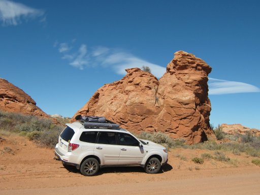

Drove to Kokomo, IN to purchase a used Tepui RTT.
It begins.
My choice for mounting my recovery boards. So much wasted space beneath RTTs and frankly no other place on my rig.
Shovel mounted with Quick Fists and plumbing soft couplers from Home Depot.
A Tepui RTT can hold a lot. In this photo you see the 'burrito' we make every day when we fold up the tent. Inside are the following items: 1 double sleeping bag, 4 full sized pillows (thin cheap kind from Wally World so they compress small), 2 small pillows for additional support beneath the thin full sized, a sheet, a military style wool blanket and our pajamas.
This cooler rocks. Actually keeps ice for 3 days and doesn't leak a drop. Love it.
Getting organized was key. These ammo cases from Amazon are awesome. They stack tight and don't shift an inch when driving. Bigger ones in the back behind the ones you see on the right.
Our dog loves our RTT now. He tries to jump from ground level to the entrance to get inside if the weather kicks up. Haha.
Reactions: Jimmy P
