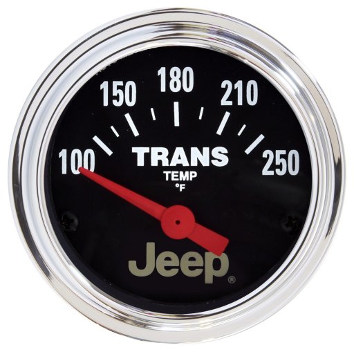

The top pod has this transmission temperature gauge mounted:

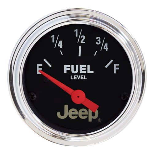

AutoMeter also make a matching fuel gauge:
Unfortunately, they only have it in the 0/90 and 73/10 ohm ranges. They do not make a Jeep 240/33 ohm gauge. There are 240/33 ohm gauges that come close, but none that match perfectly. By going this route I would have non-matching gauges, a stock gauge that I cannot remove as the instrument panel is one large piece so it would just sit there non-functional, plus I would use up my other A-Pillar pod which I was planning on using to mount a transfer case temp gauge. So, option 2 is better than option 1, but still not ideal.

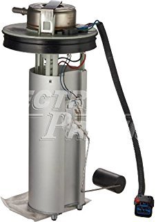

Here is the new fuel sending unit:
For those of you with experience, can I straighten out and adapt the older style sending unit and make it fit into the same hole as the newer sending unit? This seems like it would be the simplest solution, but I do not know if the tank holes for the sending unit are the same size and style for the two different units. Any info or insights would be helpful.

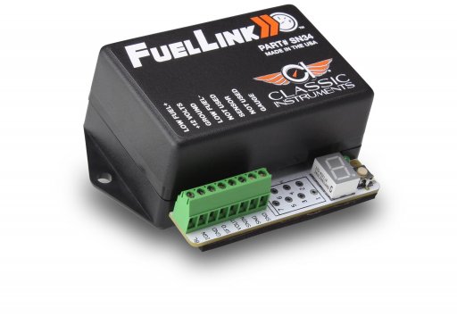

I got some good advice on some of the other forums, wanted to close the loop here. The FuelLink sensor can convert any sender unit ohms to any fuel gauge ohms. It can also be customized if you have an oddball sending unit or fuel gauge. Simple solution for only $135. Also, it's not vehicle specific so if any of you are looking to upgrade your fuel tank size and need a different fuel sending unit, this may be a solution for you too.
