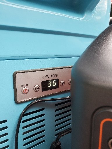

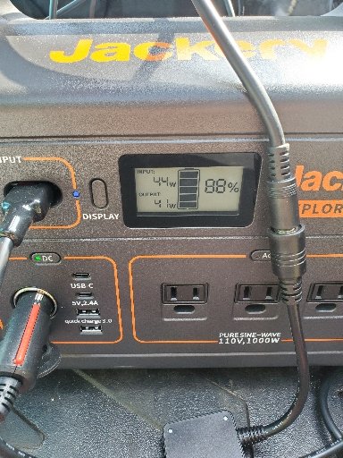

41 watts when she runs hard and 2 the rest of the time. Not sure what's going on with yours.
