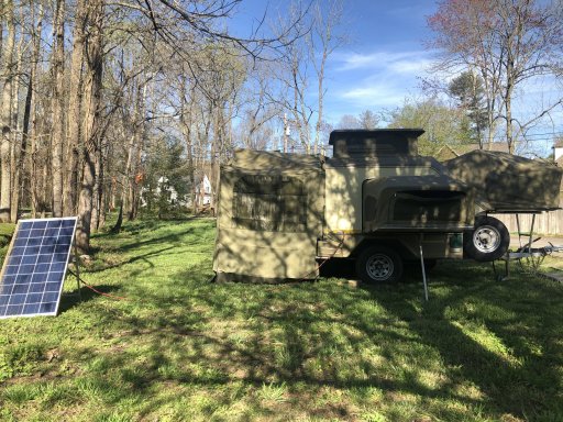

Pretty compact. 11’ long trailer. Made by imaginetrailvans.com in Africa. I imported one back in 2016. Averaging 50 nights per year in it.
Solar panel is removable to track sun all day.
two double beds pop out front and right.
top pops up.
I normally just run with the batwing awning (NOT Pictured) which takes literally 30 seconds to put up and is fantastic. But sometimes when you’re going to be somewhere a few days like elk camp, it’s worth putting the attached tent up.

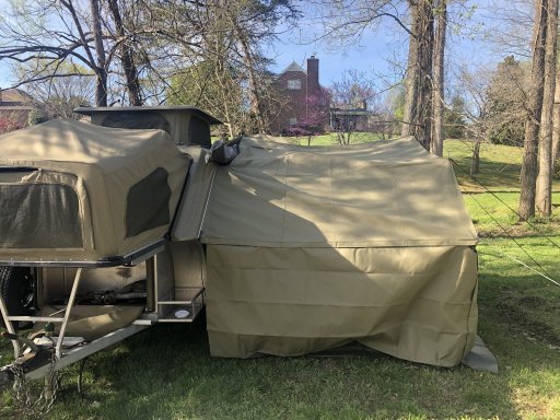

As you can see in the next posts there are 4 wall sections and they Velcro to the roof and each other and connect to the floor mat which I didn’t deploy because it’s a little muddy and I didn’t want it to get dirty yet. (Defeats the purpose of spring cleaning)
But you can run with any combination of walls or no walls at all.
for perspective the enclosed tent portion is about 15’ on the long side.
And I’m 6’5” and my head doesn’t touch the ceiling anywhere inside.

putting the walls up...

apologies for the Dogwood Shadow camo. sun was obviously setting behind me.
5402EB2B-4519-4432-ACA7-6C4563345555.jpeg179FA3EB-19BB-49BD-AA4E-EEC4D319201C.jpeg43A2EFC2-0C8D-40B0-9116-9C016CA04A54.jpeg3C5C2218-EEEB-43DB-96ED-847CCC5A4C4C.jpeg
following pics are like ones above, but i added the rain fly over the bed sections. i've never gotten wet with these things. however, when the wind really comes up (like >40mph ) they turn into giant sails and start flapping off, so i pack them in. fortunately, i haven't had a combination of rain and high wind, always one or the other.
adding the ground mat, and tightening the ropes will take the sag out, but i'm just cleaning today.
