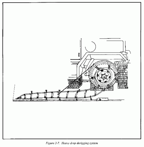

US Military makes a "derigging ladder" designed to move a vehicle out of a transport aircraft. A nylon grid ladder (1.75" webbing) spools around the tire (s) to move the rig. Messy to be sure esp in the mud but they are light weight.
