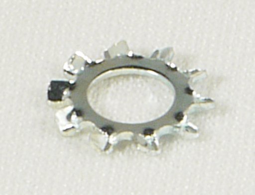

The suspect ground is a target. Find the ground, all of them and place a "snowflake" washer under them to improve "continuity"
There are a few, upwards of 13 or 15 on the car.
Next do a "torque test" on the engine mounts. Get a friend to hold the brake and push the gas at the same time and watch the engine and mounts to see what happens.
Does it move, shake, vibrate at different RPMs.
Finally what are you doing with the codes?
You said;
The only times i get misfire codes are when my car is driving smooth which is weird.
Are you deleting them?
Go to OReilly's and have them scan the truck and print out the codes. It will list them all. Don't pick and choose what others recommend. Get all of them and list them here and I'll take a look.

Lmao, thank you for all the info, I have an OBD sensor so I just check the codes when they come in. I had a shop recently print out all my codes but they were what my sensor told me. I will try a torque test and for sure fix the ground. But I am suspecting some kind of fuel leaking into my engine.
