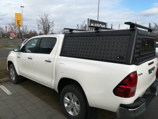

Received delivery of the Hilux yesterday afternoon.
Today I went to the shop to install the canopy and roof bars.
The fridge slide is in
The canopy is made of aluminum, and the attention to detail, finish and insulation is amazing. Tomorrow, when I will have better natural light, I will make some pictures with some of the details that impressed me. Too bad this company is not very well known, at least in Europe, most who want an aluminium canopy go straight to Alucab, they don't look at anything else.
It is not perfect, but very good and well build. One issue is the fact that it has 2 locks for each panel. I understand why, you can't seal the panels properly well if you have only 1 "anchor" point , but still.. it is a bit of work to lock/unlock by key , a total of 6 locks if you want to open it on all sides.
The fridge slide, like the fridge, is on the cheap side, not great action, takes a bit of force to slide, but it seems to work ok and solid enough.

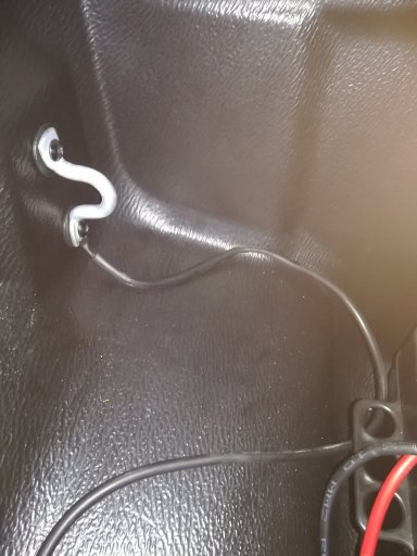

I started with the preparation for the wiring of the auxiliary battery.
red zip ties so I know what to cut if need it.
Many say you can get it the back of the bed via the Stop lights.. bullshit.. you still need to drill
1 h later the wire is in :)

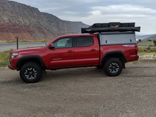

Dana Ramos
Nice truck! Like @Chris Ludwig above. I have the North American version of the Hilux. Canopy and tent are both from a South African Mfgr and I've been very pleased with them. Wish the truck had a diesel though. Or at least a V8. My last rig was a Jeep with the 5.7 Hemi and I've definitely missed having that kind of power/acceleration.

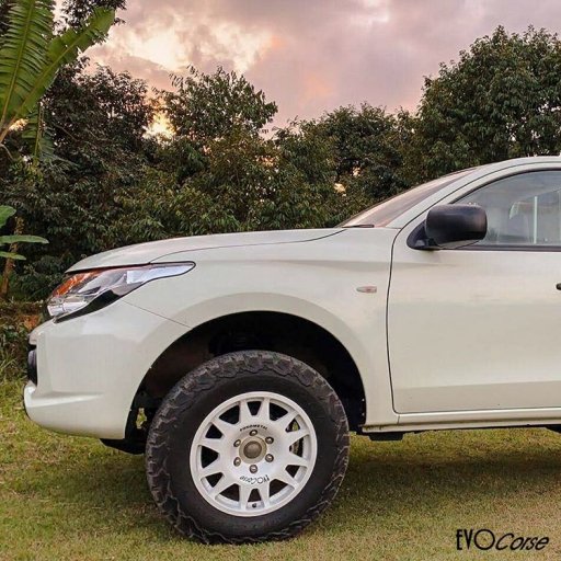

I was looking at a new set of tires to replace the stock ones, they are not that bad, they are AT but they are Bridgestone dueler AT, not the most aggressive thread...
So I decided to get full wheels, and the stock set to be used outside overloading season.
Initially, as rims I wanted to get some steel or maybe some cheap alloys, so I won't cry when they scratch, but I stumbled on this wheels.. evo corse dakar.
They are made by an Italian company, like half of the dakar rally teams use them, very resilient, one guy had a flat 10 km before the finish line and he managed to finish, the rim had only a small crack, but survived in those conditions..
Had a good deal on them but still for 5 of them i paid about 600 euro more than some cheap ones, luckily the wife was preoccupied with something else.. :) .
The crazy thing is that I got them in 17 inch white.. I think they will look good on my white truck . Triple powdered coat so they should not chip so easy,
A very vane thing to do but I could not help myself... :) .
Delta 4x4 Dakar are also very good wheels, but they don't come in the proper size for a Hilux, would have been good quality and reasonably priced..
I can't wait for them to arrive, and as soon as they arrive I will get a set of Falken Wildpeak AT .

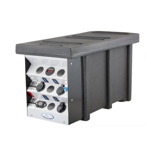

Had some issues with the auxiliary battery box, one of the wires was moving arround and it snaped, it was exactly the power to the fridge, so it was annoying. I had all need it with me, and easy 10 min fix.. but still..
Instead of building something custom, I finally decided to go for a National Luna battery box
It has all the wiring done inside, well protected . A bit expensive, but in Europe there is not much choice . Like usual with Overlanding stuff , Australia has many other options for pre wired boxes, and better prices.
My current 100 Ah AGM should fit, but it will be tight. I hope I don't have to change it. It is 3 years old but still holding very well.

The battery box arrived today.
This is why I need it
It looks worse than it is, when the aux battery is in, it is bit cleaner, I have fuses everywhere and it is safe.. but still...
My 100 Ah AGM deep cycle is a snug fit, which is fine, I don't want it to move around..
The front of the box. After installation I should have an in, an anderson plug and an out for the fridge, that is it. Much cleaner than what I have now.
Enough possibilities for plugs for me, I will have some free ports for the future if need it.
In the week-end I will start the installation of it.
I need to find a way to keep the box in place with some straps, I don't want to bolt it down in the bed, I want it to be easily removable. So I need to find a solution to fit some tie down points. I want to place it in the same spot as the old one, in the back of the bed top left corner.
Any suggestions are welcomed.
