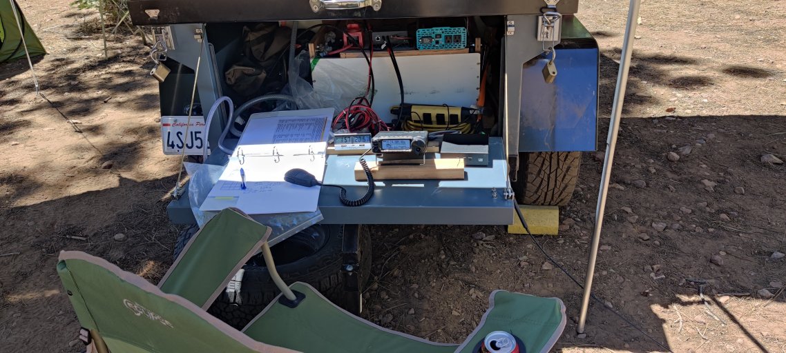

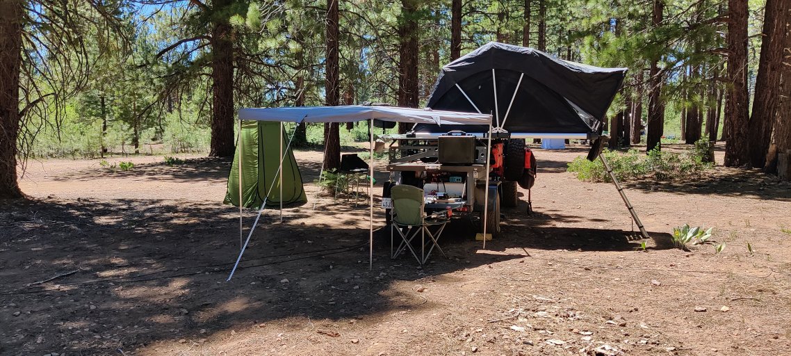

This last camping trip was partially to test my 14 mhz ground plane antenna. It's a 17 foot whip (Chameleon) mounted on top of a telescoping painters extension pole (Home Depot) . It's strapped to the side of the camper and guyed by the ground radials. The 45 degree angle raises the feedpoint impedance to around 50 ohms (about 20-30 at ground level) so that the SWR is less than 1.3:1 over the entire 20 meter band. The advantages of HF are distance communications i.e., I made contacts with Alaska, California, Iowa, Illinois, Connecticut, Florida, Texas, and Arizona, both CW(morse code) and SSB. No need for repeaters, internet, or permission from anyone. I was running an ICOM 7100 at 100 watts and the components and wire gauges are good enough to run an amp to a full gallon (1000 watts). $$$ . Next trip will test a 7mhz antenna (40 meters) which will be better for 200- 500 mile skip. I'm kind of a beat to fit and paint to match sort of craftsman...
I have the 7100 mounted on a cup holder and I also use it to run 2 meter vhf (antenna poking up on the corner of the camper). I have the Midland 575 hanging near the glove box (their stubby antenna mounted on the plate on the roof of the camper) and a Midland CB on the other corner of the camper.
