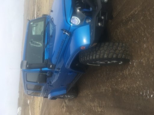

Is there a antenna that you would recommend?
Dose the fiberglass topper effect ham radio like cb radio

I have always used Comet SBB5 antennas with good results. Fiberglass tops always effect antennas. This a question of antenna theory and RF propagation. The SBB5 is a ground independent antenna thus grounding isn't much of an issue. But no matter how you slice the pie you will need a ground plane and fiberglass doesn't provide one. But don't worry other solutions exist. The best solution in this case is mount the antenna on the hood, the radiation pattern won't be uniform but it is still an effective solution. Alternatively you can mount the antenna on the roof and then built you radials or a ground plane onto the underside of the fiberglass.

dose the antenna have to be calibrated the radio

Tuning and testing an antenna is always a good idea. But as a general rule of thumb the antenna sold by diamond, comet, and nagoya will maintain their published SWRs. So is tuning necessary, most of the time no. Would I recommend it, yes. For me this really a question of if want to spend the money on an antenna analyzer or not.

Will it harm the radio if it was not done right away?

That is question of severity. As a rule of thumb no, especially seeing as most antennas from reputable manufacturers needing little to no tuning. But in the event of high SWR it is possible to damage the internals of the radio. However such cases are uncommon.
